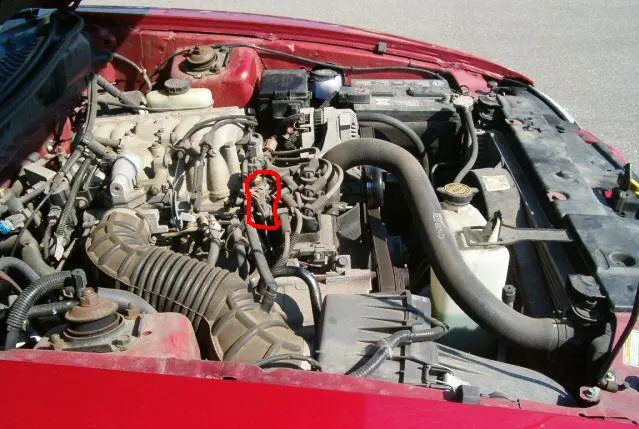

thats my problem...im at school a little over 3 hours from home (where my car is) and i would like to get that hose here at school and then i can go home, put the new hose on, and drain the water out of my system and put antifreeze in there asap so i dont forget about it and come home from school to a cracked block once winter comes...
this is the best picture i could find, you cant really see the hose but i showed where the hose is...its a rubber hose (about 6" long) that is connected to a steel hose at one end (passenger side) and it is hose clamped to some sort of fitting on the other end (drivers side)

Mwahahah it is a heater Hose!!!! :D Its not too bad to change just take the ignition module houseing thingy off ( I know thats most likely not the proper name so what! :D )and vuala. I had to take that house off when my cam shaft position sensor went bad. You can get that at Advanced Auto Part :nice: "We're Ready in Advance" :flag:
