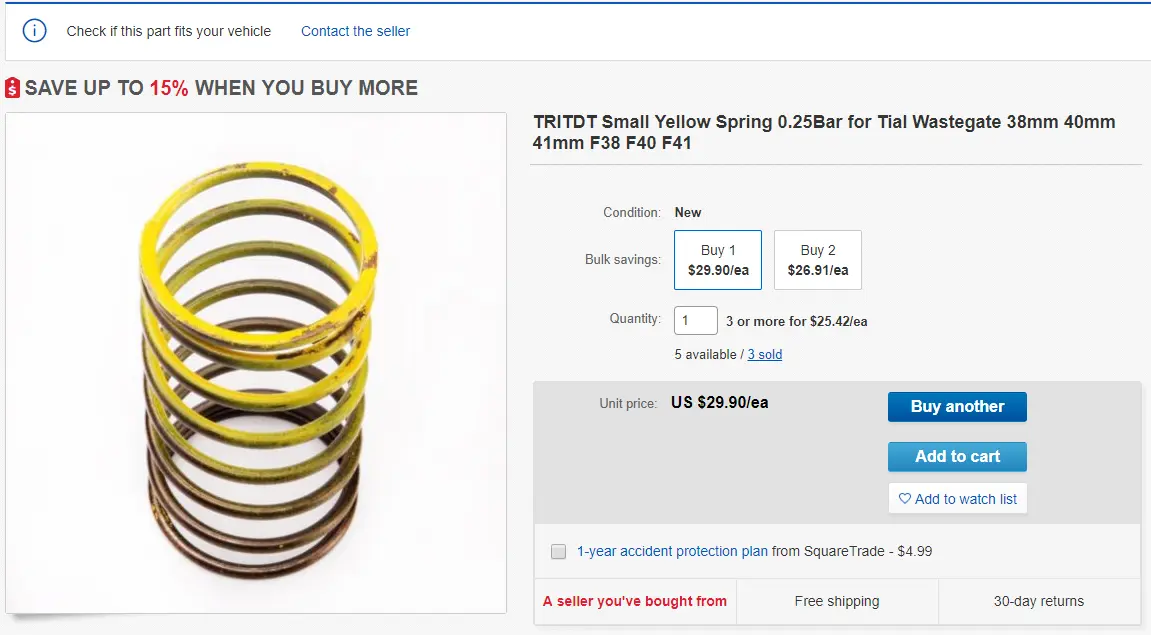

im gonna switch to the smaller spring tonight and start this over again. 8%-9% must be to big of a change on the tight of a spring. so if im wanting to net 12psi should i set my boost protection to 14psi when its all said an done? that would be 196ish ?
@a91what hoping this takes care of my problem.....
i put the vac line to the bottom of the wastegate only and drove it a lot this weekend. no matter how much duty % i put in the table it was 6PSI
