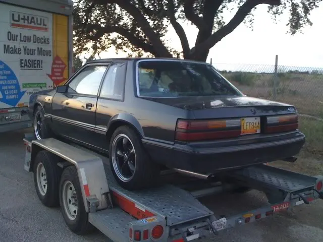

Some pics I found of Jonathan from LRS's car while searching for these exact wheels....
Here's what appears to be a 275 on a 9" wheel on the left, compared to the 315 on the 10.5" wheel on the right.
