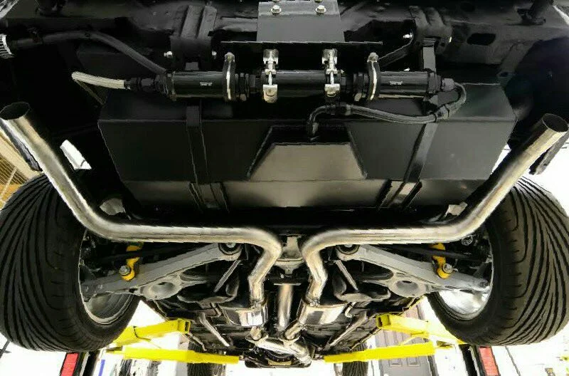

Glenn's makes a nice replacement tank with a sump setup. I bought an aluminum tank from Behind Bars Race Cars. 14 gallons. Bolts right into the stock location. I personally wouldn't bother with a fuel cell in a street car. My fuel system is 1200hp capable and I can run the tank to 1/4 tank without issues.
