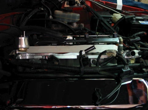

Take some Mothers metal polish, and fine steel wool...give it a rub down and that should cure it....its stainless steel, so hopefully its not pitted....i give mine a douche in that stuff everytime i can get at it....
Mothers or any metall polish should have it looking like this....stainless normally cleans up decent....same as the stock tails will...
