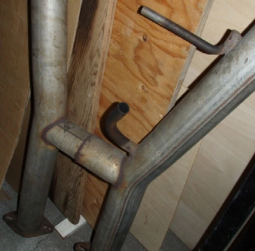

hey guys, i ended up getting the pipe for 60$ and its in good shape. I just have a quick question, it has what looks like a pipe for the AIR system on it.. now the purpose of the AIR is for the cats.. I dont think its needed for a catless pipe. Heres a pic of the little pipe, whats it for?

Smog pump line connects there.... just connect it... don't plug the line coming from the car. it causes stupid ****... and not conecting it makes your car sound like this....

I eliminated my smog pump and welded a bolt into that little pipe after cutting it off close to the actual H-pipe. I then got a CEL until I had a chip burnt that included shutting off the smog related stuff. Weird part about it was that the CEL didnt come on until a few months after I took the smog pump off... If you still have your smog pump, then I definitely agree that you should just go ahead and hook it up.

I welded the tube on my o/r X shut and removed all the smog equipment. Didn't throw any codes.
shouldnt throw codes, only EGR throws codes after being deleted. Im planning on deleting my smog pump and related equipment in the near future, but for now ill attach it to my o/r H.
