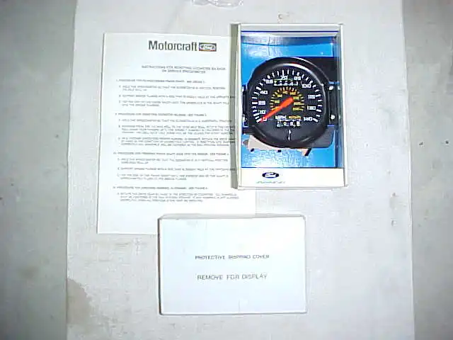

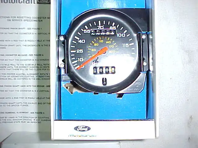

The motorsport speedos actually ship with instructions on how to match up the miles. I have found a picture of this doc, but unfortunately the quality was so bad I couldn't read it.

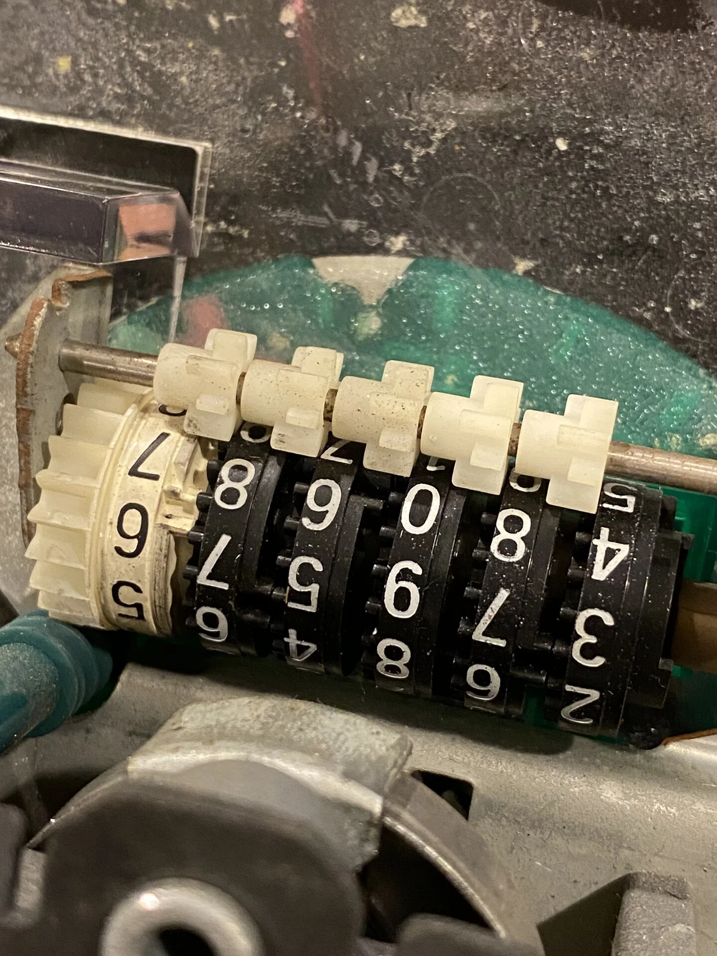

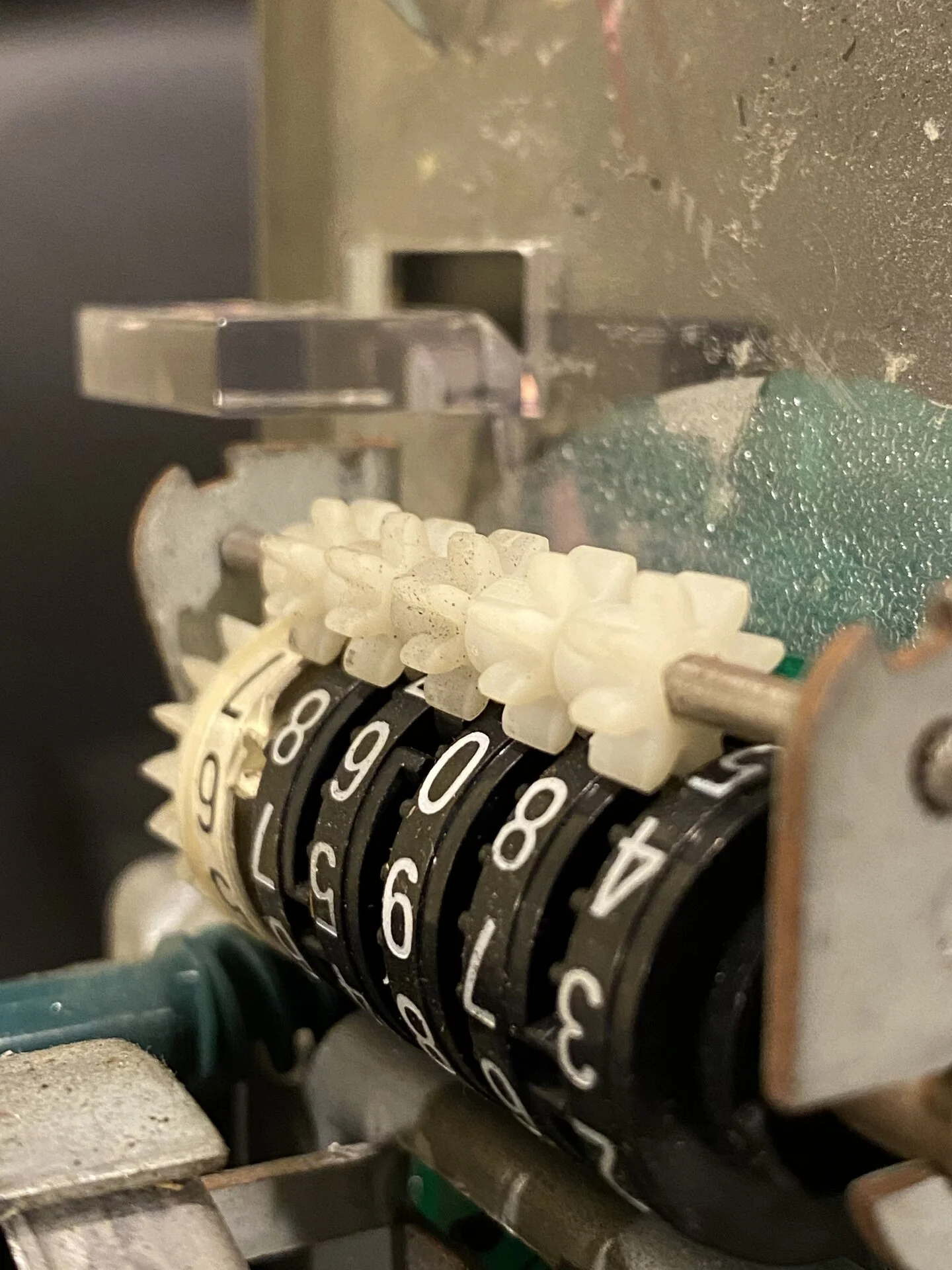

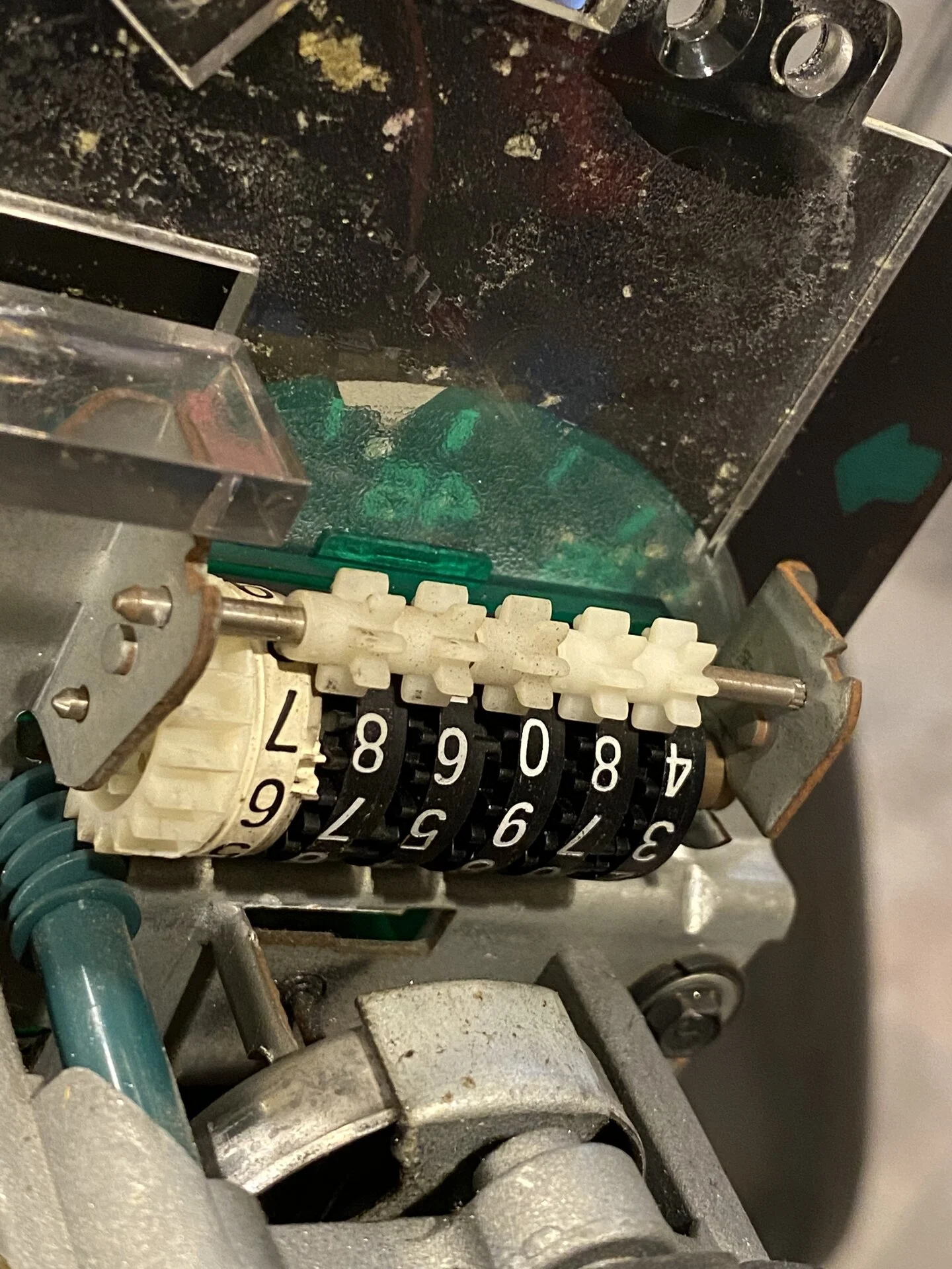

How I do it is to flip the speedo over and look at the odometer from the rear. There's a small rod with white gears on it that advance the miles. If you tap one side of the rod out, you can lift the rod and spin the odometer to where you need it. Then you can reset the white teeth. The white teeth have teeth of different sizes. One big, one small. The big tooth fits into a large slot on the odometer which moves the digit up one spot. It doesn't nececcarily make it difficult, but if you study how the teeth fit in, you'll see how they much sit once you are ready to replace the rod.

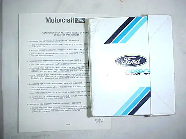

However, If someone can find the Ford motorsport directions to correct the odometer, i'd love to read those
Found it. Unfortunately can’t make out what it says. The large print references "Instructons for resetting odometer on service speedometer"
Here’s detail of the odometer and the white teeth.
The 1 way clutch is located inside the big white gear. The numbered portion and the toothed part are two separate wheels. They can only spin forward together, but if you spin the speedo cable backwards, the geared part free-wheels against the numbered wheel. It simply won't work. You NEED to go forward.
