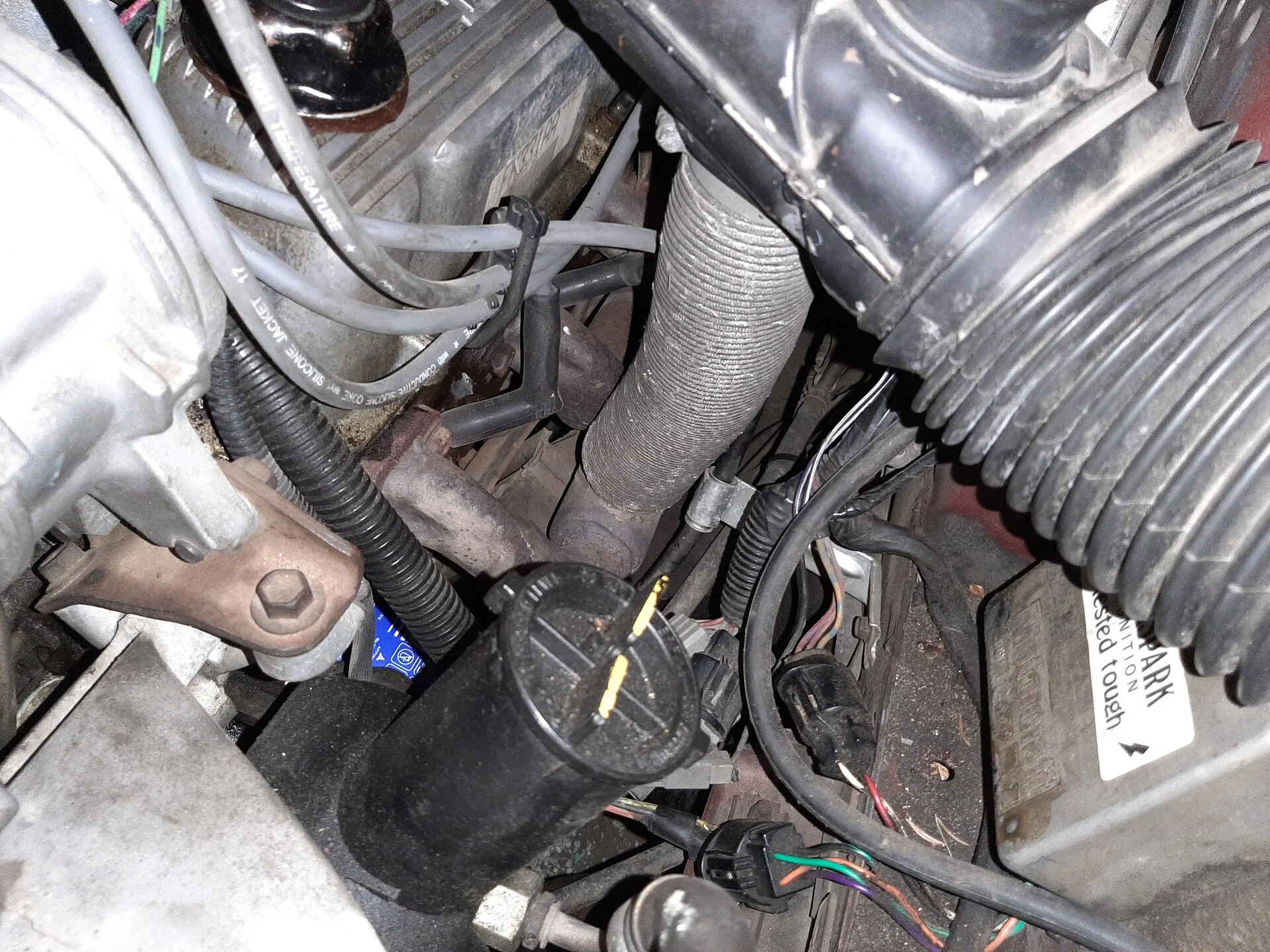

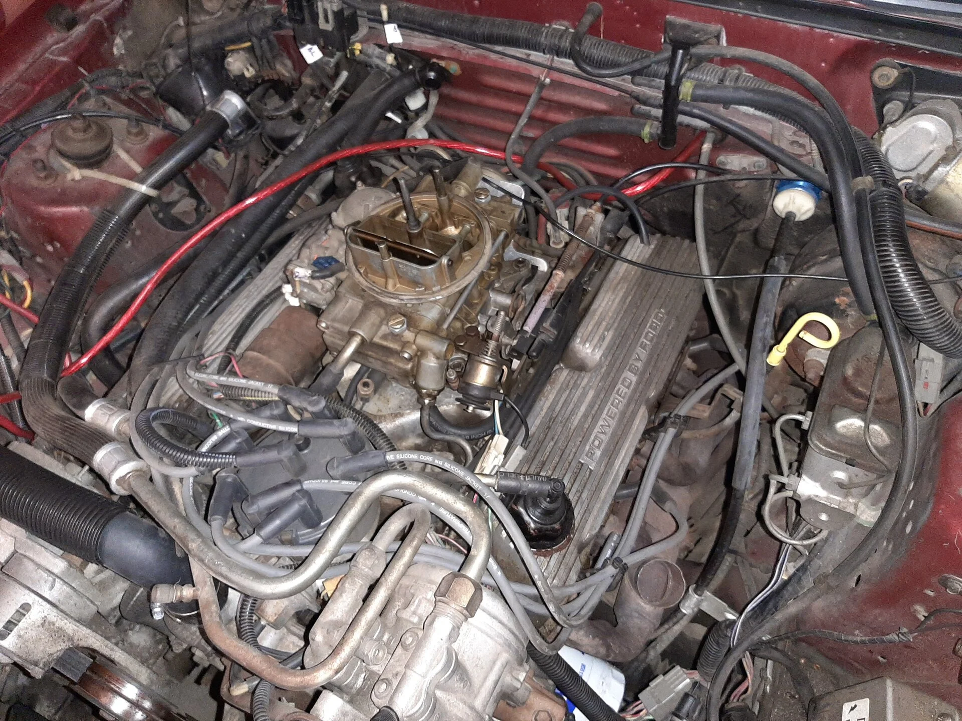

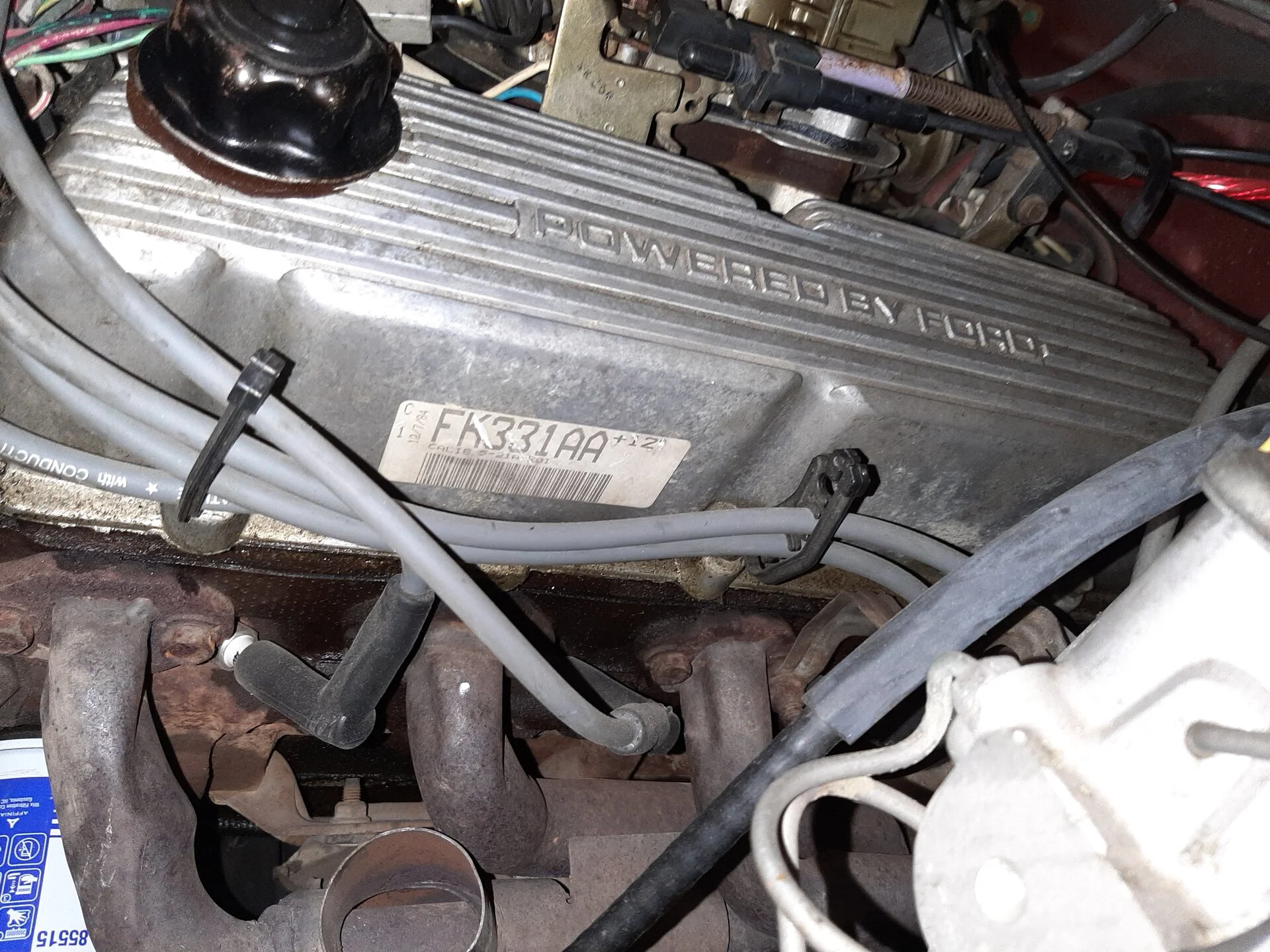

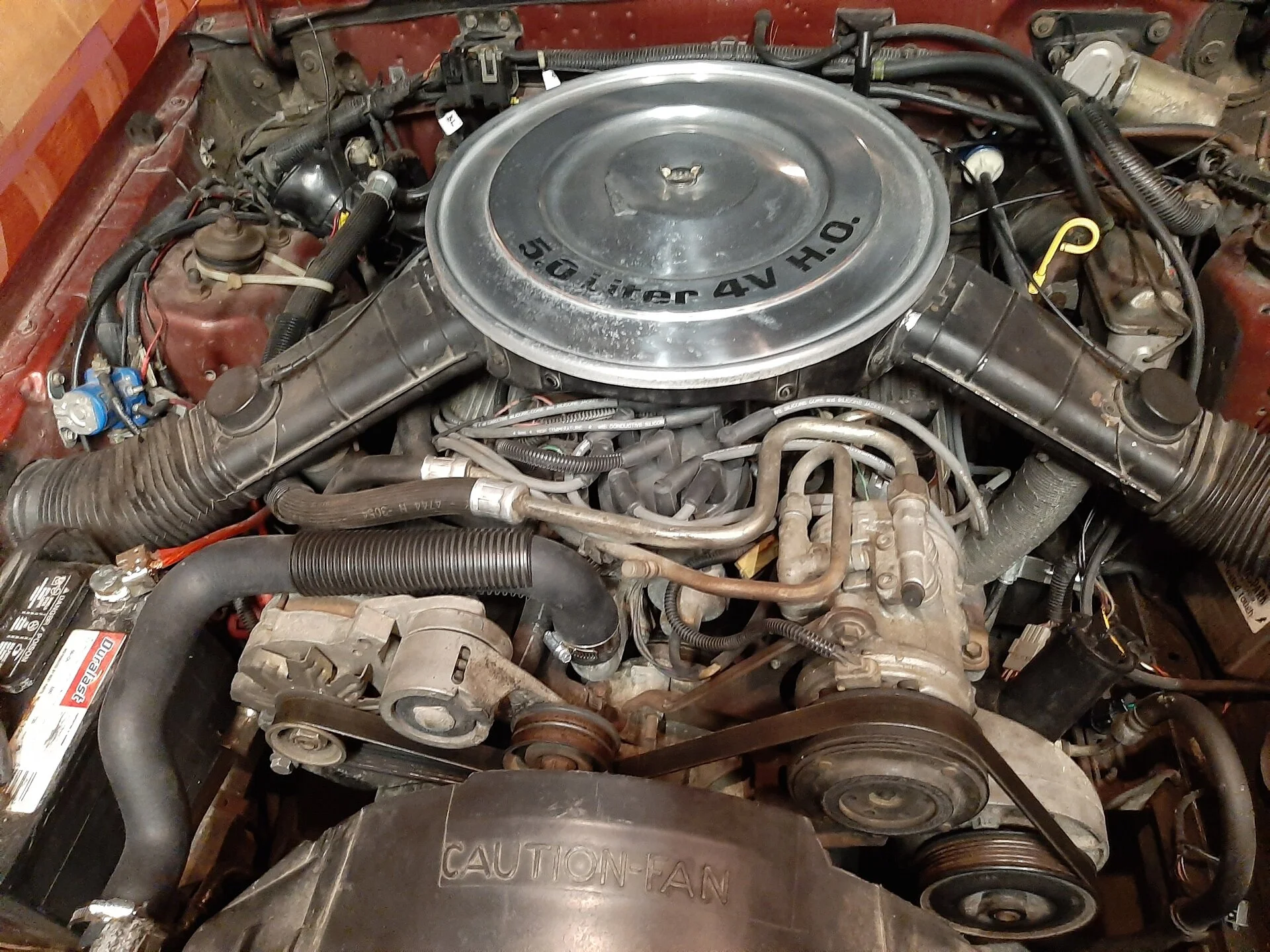

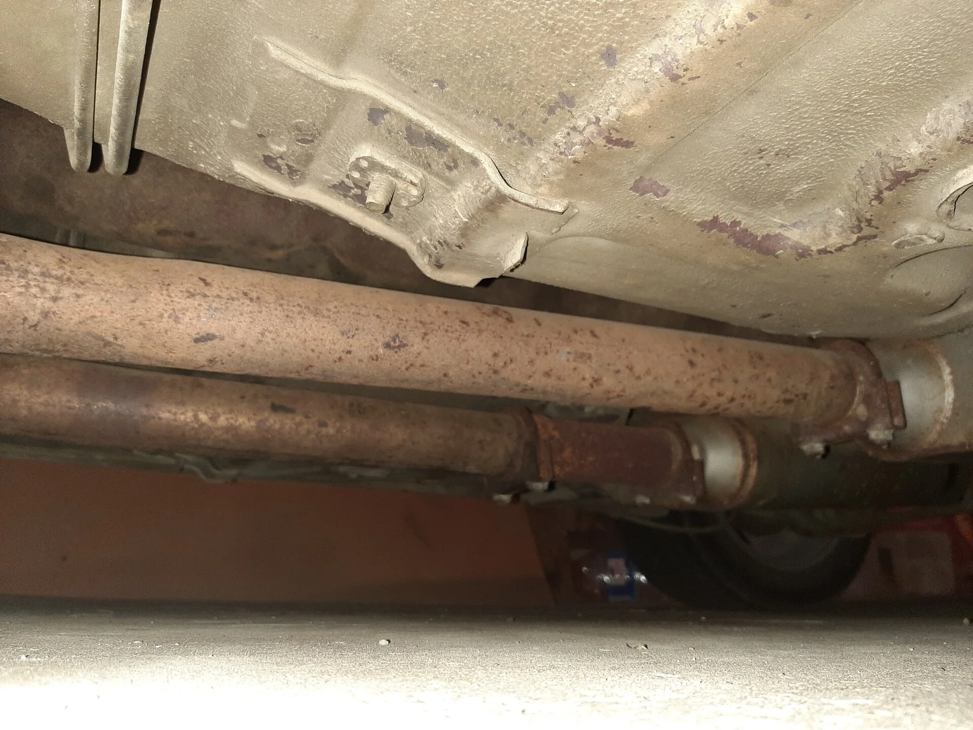

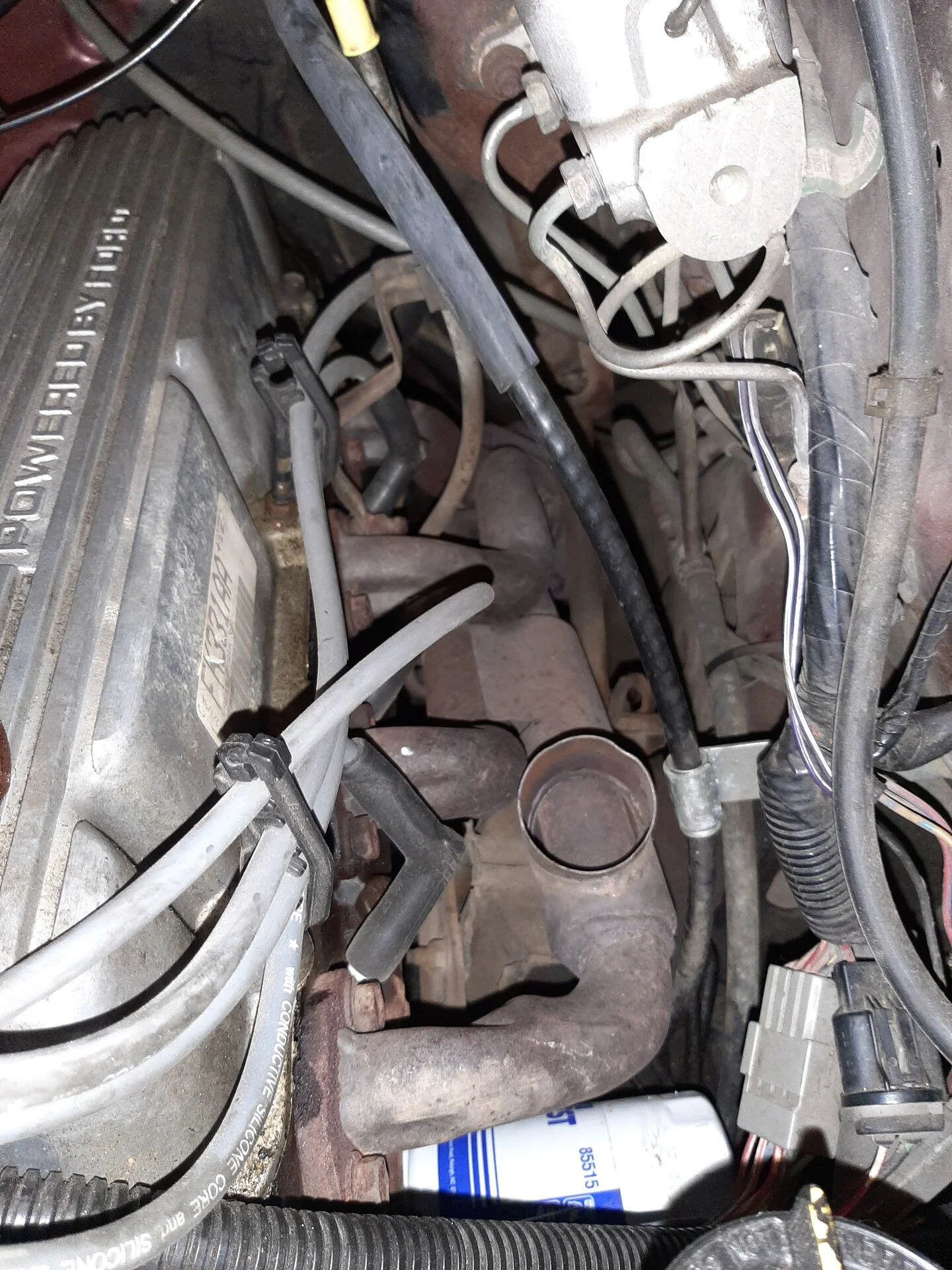

Please post pics of the engine bay, including intake, carb, ends of the heads, exhaust and front accessories. The tear control arms and exhaust are often modified for more power, but can be modified for something to blow money on.
I've never owned a mustang gt before, I didn't know how fast they were supposed to be and I didn't push the car at all because it was old and had alot of bugs I had to work out of it before I felt it was in prime condition. To time it I had a friend sitting in the passenger seat hit a stopwatch as soon as the pedal was depressed. And watching the speedo hit 60 and hitting stop. Not perfect I will admit but still accurate enough to tell within a half second I would imagine. The first three runs I did have major issues with the tires breaking loose and times were 6.3, 5.8, and 6.7. But the fourth I got a perfect start and he registered 5 seconds flat. It's a stock carb, tuned by a professional mechanic when I had it rebuilt after I bought it, exhaust does seem to be aftermarket, the headers seem stock ( they have factory crimping at the bends). But it does have a massive acceleration at around 3000 rpm up to 5000 rpm. The reason I never really noticed much the first few years was I don't drive it much and I had alot of bugs I had to work out of it before I felt comfortable pushing it. So this is the first summer I've really been pushing it and I do notice it seems very fast when I push it.. but on outward appearance it looks very stock. I don't know. I'm not really a mechanic and this is my first working mustang gt so I just figured I'd ask.

You have a good looking car. I see a lot of stock stuff there, and that isn't meant in a bad way. Looks like stock heads, stock headers, stock carb to me. It possibly has gears (which is a common mod) and if so 60 MPH might not really be 60 MPH.

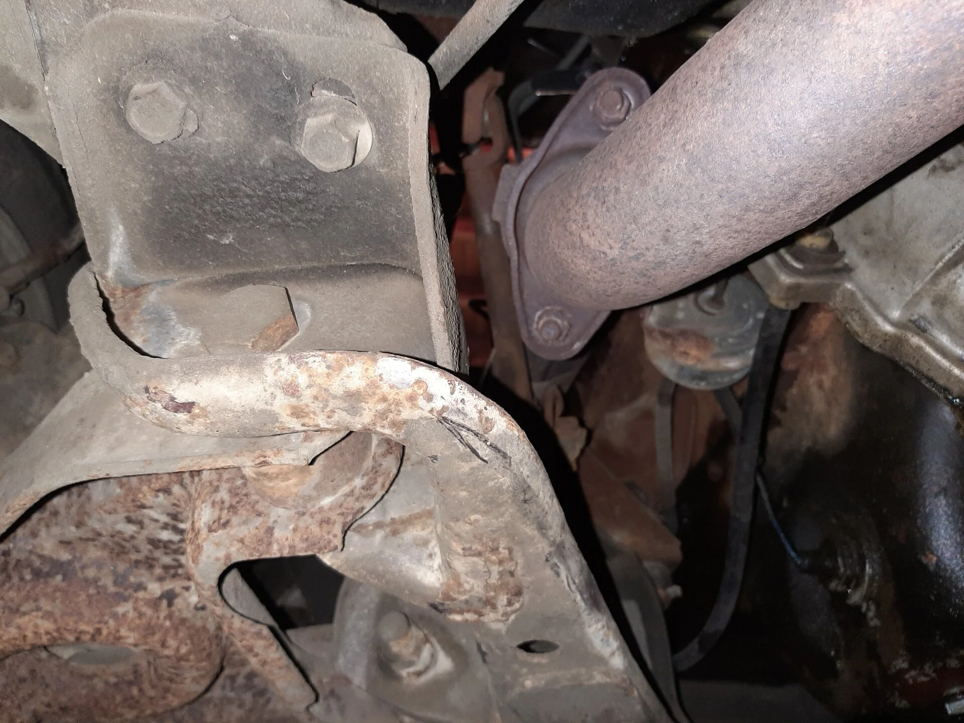

Looks like the "smog pump" is bypassed, if it is even there any more. It also has dual mid pipes, instead of the original one, and aftermarket mufflers. Can't tell if the lite-off or primary cat converters have been removed...no pics.
