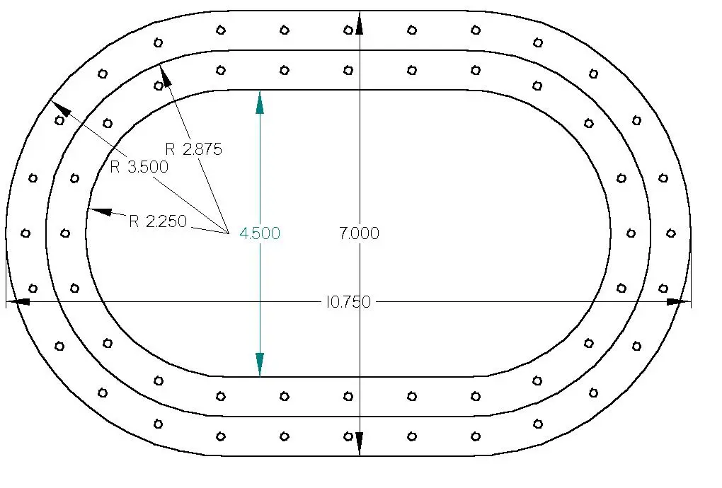

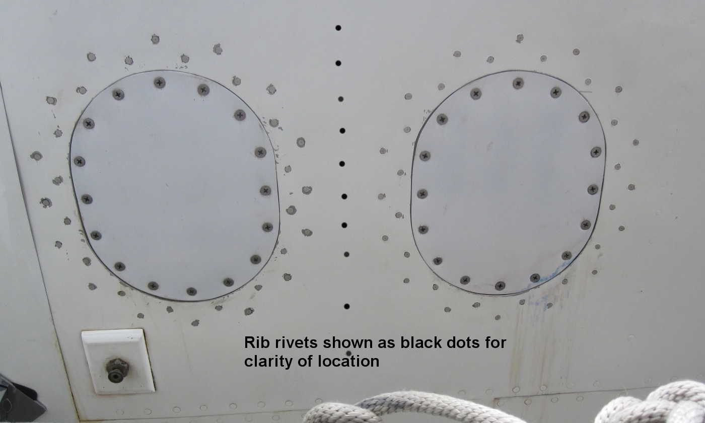

The answer is called a doubler plate. Every removable aircraft inspection plate or access cover has a metal ring that overlaps the hole and provides a mount place for the cover. The doubler plate is typically 1" larger than the hole and is riveted or spot welded in place. It has a lip that is about 1" smaller that the access cover that goes over it. There are nutplates on the bottom side of the doubler for the cover's structural screws to have something to fasten to. Airplanes don't use sheet metal screws to secure inspection plates - they offer no structural support .
See the picture below and you get the idea...
This is the doubler plate....
