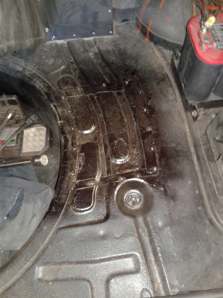

One of the single best things I've done is cut a hole in the trunk floor to allow access to the pump. If the car is stock, it's one thing,...the pump rarely needs attention, but add some power, and a 190 lph pump gives way to a 255, that gets replaced for a 340 unit once a turbo and big injectors start entering the pic.
Who in the hell wants to drain the tank, and fight it off of the filler neck, when you can remove ten screws and be done?
And once I carpet this trunk,...whose gonna know what's under that?

If you have the mindset to do the job, making it seal to the trunk floor, look like you actually put some thought into it, not a hack job with a coffee can cover I'd say it's not a bad Idea, like mike said, makes future mods easier.

And if there was a way to make an access panel look good, I'd do that.
For the same reasons, and maybe even more, if I had a stock heater core and was faced with having to replace it, and have to remove the whole damn dash to to it, there'd be a plated cover on that side of the firewall too.
