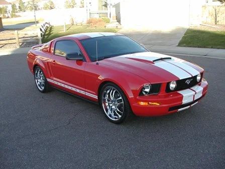

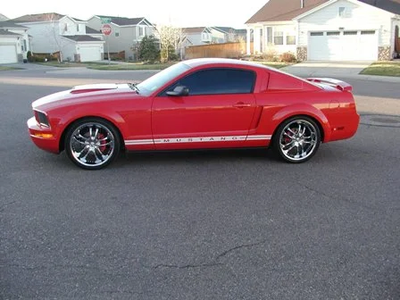

Guys, I'm lowered with the Eibach Pro-kit and 20's which will soon be 18's in Halibrands. No problems, yes you will need an alignment, I don't know about that panhard rod, I haven't had the alignment completed so I don't know if I will need camber plates. check out the pics.
Holy s**t! That is amazing!!! I love the hood scoop! Man and both the louvers look awesome!!
Did you get them professionally installed?? Man they look hella-great!!!
Thanks for posting!!! :nice: :flag:
Kevin, Thank you. No, I did everything myself, with the exception of the paint. Lowered, Striped, Scooped, and so on. Not that hard to do just need to make sure your prep work is up to par before installing.
I just swapped out those 20's and went down to 18's. I picked up 18x9 Halibrands in chrome with a +34mm offset...looks really good I think. I'll create a new post when I get pics.
