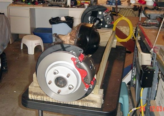

Anybody make their own Mk7 rear disc brackets?
5.0ina66
Jun 6, 2003
664
Ohio
Well I have this rear disc setup sitting here and no way to mount it. Add in the fact that I'm too cheap, too broke and too stubborn to yak up the $150+ for the brackets, I'm sitting here wondering if any of y'all have made your own brackets to bolt up the Mk7/Conti/SVO rear discs? I have access to a welder, bandsaw, drill press, and pretty much anything I would need, along with way too much free time, and they look simple, but I know I'd probably design a POS without some help.
Thanks in advance
-Kyle
PS: The rear end is a stock 8", I know that matters.
I used the Mk7/Conti/SVO rear discs years ago on an 8" rear out of a Granada that WAS in my 66 coupe. I used the factory 8.8 brackets, cut them just about through the middle of the large 3" dia. hole, then mounted the rotors & calipers, aligned them on the axle housing and pressurized the calipers with air. this held them in place while I welded the bracket directly to the housing. The setup worked great with my Granada fronts, but tended to be a bit touchy....I could stop the car on a dime but the brake lights would hardly come on until I was at a standstill:shock: . I know the factory 8" in a 65/66 Mustang has the necked down tubes so it can't be done that way on those unless you make the bracket with a smaller hole.

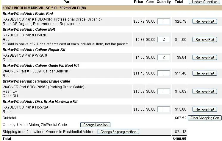

Here's a list of parts
