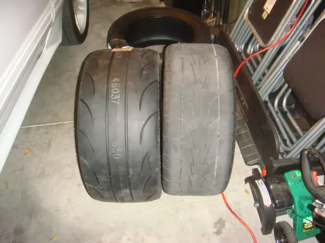

nitto's are about the skinniest tires in the industry
Same size tire 275/40-17 Mickey Thompson VS Nitto
