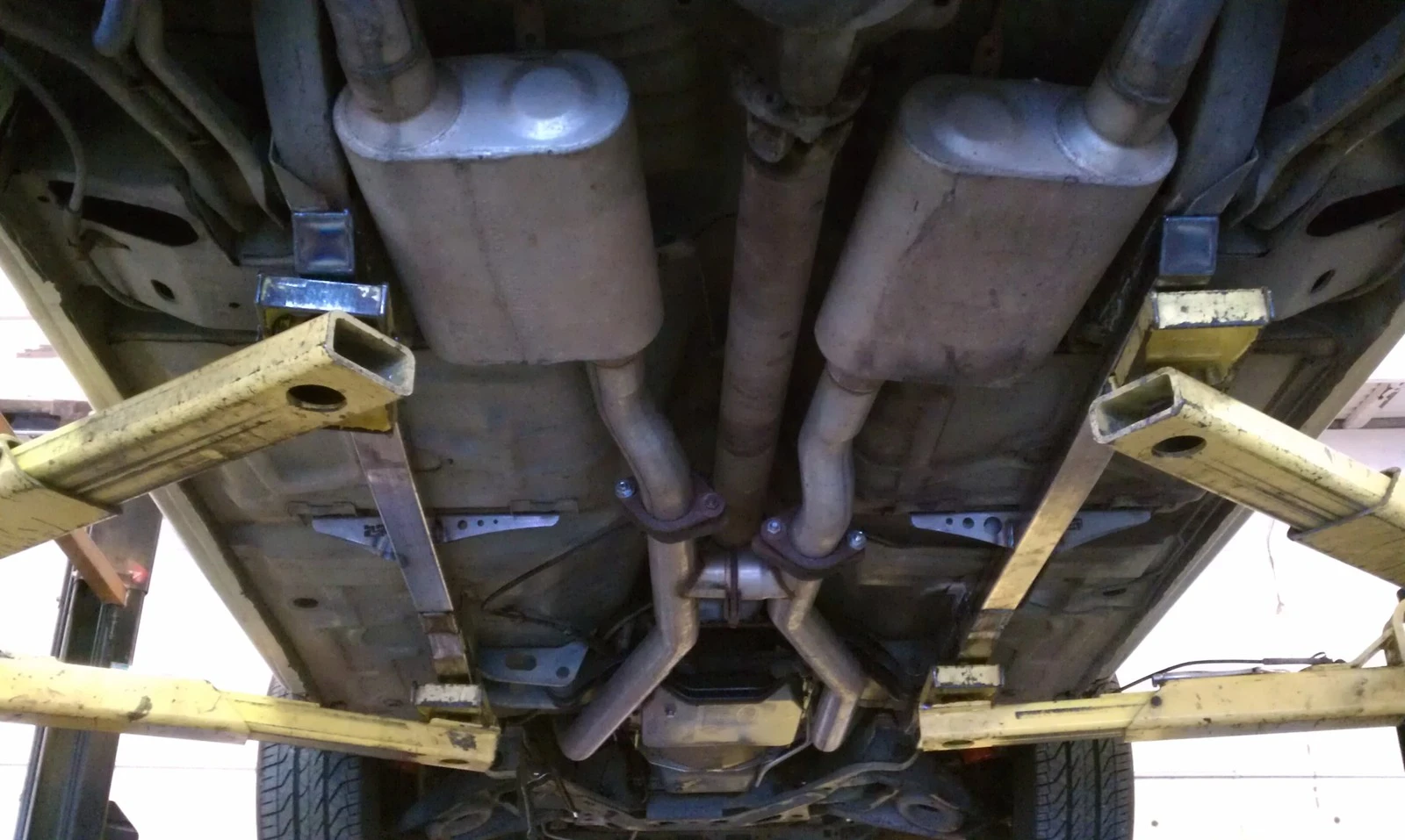

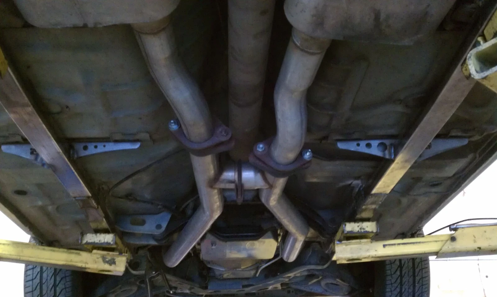

here is all i have. Prob dont help you much. Maximum Motorsports FLSFC
Those pics look like them. My MM's go from about the firewall all the way to the torque boxes. Normal ones are just long enough to overlap sub frames by 6 inches usually if that. I dont have pics of mine offhand but i can take some next week when putting the transmission back in.
Ive also noticed that the boxing on the shorter ones is smaller. Maximum Motorsports makes a great connector. These work well enough so that my door no longer tweaks when the front is lifted off the ground.
Thanks guys. The chassis shop that I'm taking my car to said they can make a custom set for me. They said they can make them as lon as I need them. I figured the MM ones went from the firewall to where the rear subframe of the car curves up.
