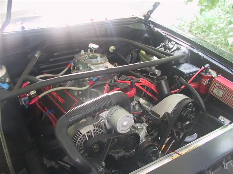

I recently did the conversion, and I'm very happy. I'm running a mild 347, w/trickflows, Weiand ported/polished intake, Demon 650, Barry Grant 280GPH pump and an Aeromotive regulator. Real good combo.
BlackVert said:
OT, but wow that really cleans up the engine bay!
Just curious, does it fit under a stock hood?
Yeah, that was just one additional thing I loved about the carbureted setup.. You lose 90% of the wiring rats-nest in the enginebay. All that's left is the harness for the headlamps, and fuse box. (Of course I still had to run the battery cable, starter cable, ground, gauge sensor wires etc, but they're barely visible)
As far as fitting under a stock hood, I'll just say no. If you're very lucky, and go with a super short intake, and a really flat air cleaner, possibly.. But in most cases (on a 94/95 style) you'll need a 1-2" cowl to clear it.
