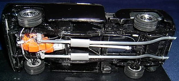

On my Chevy pickup (which was the first fully detailed kit that I finished) I had better luck that usual....For example, the front roll pan I have on that truck was originally on a 1/25th scale Chevy pickup (same body style), but that truck is 1/24th so I had to widen it. I glued it to a piece of styrene and filled the ends with model body filler type stuff, and sanded it down, it actually ended up looking pretty good. The paint came out pretty nice as well although it has a couple drips and runs.
I have to admit, though, I still enjoy looking at that truck and all the details I put on it. Gives me a real sense of accomplishment :)
