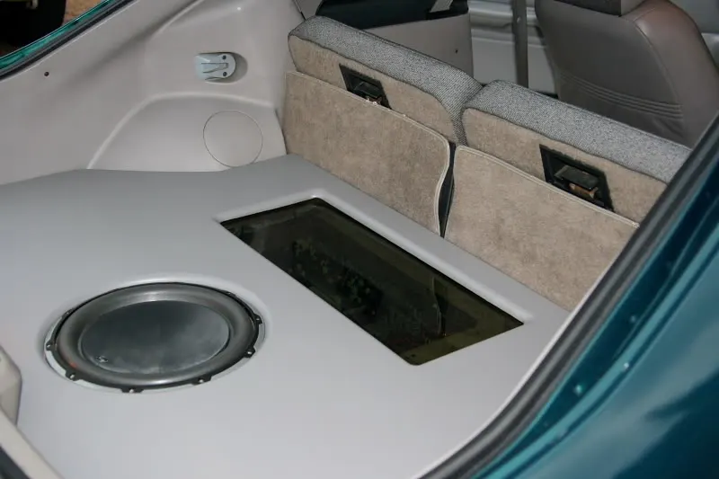

My lx has a sub enclosure that was fabricated and installed by the PO and is a really nice unit. The bottom is fiberglass and the top sits about 3" above the factory floor. It is then covered by the finish piece.
you can lay trash bags in the spare tire well and then get some fiberglass and resin and make a base for a custom box and when it cures it should fit better fitting than anything you can buy and get the most of your air space but you have to be shure to have the correct sq ft of air for your sub. how you want the top side to look is up to you.
KHibbs, that is a clean looking finished product with the cover.
Glad you like it. I am not exactly how he did the bottom part but it is perfectly molded to the spare tire well (trash bag and resin sounds like a great idea).
I can't take any credit for the design/box/cover as the PO who is a member on StandNet did everything. I am just the happy new owner......:D

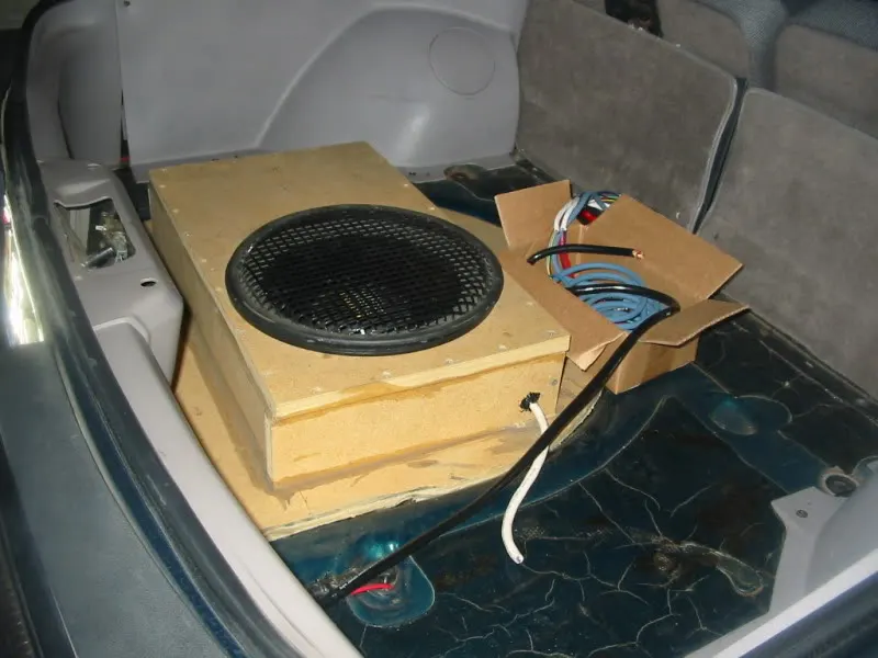

We chose not to go with spare tire for a couple reasons though... First, it eliminates your spare! As dumb as this sounds, these vehicles are one standard screw driver away from stealing. If you get a flat and must abandon your vehicle, no way insurance covers exhaust, heads, cam, intake, supercharger etc.. huge loss for something so trivial.
Second, when youve got a sub like this..
It doesnt lend itself to having enough room within the spare tire well and still having a semblance of space or flush fit. :nice:
