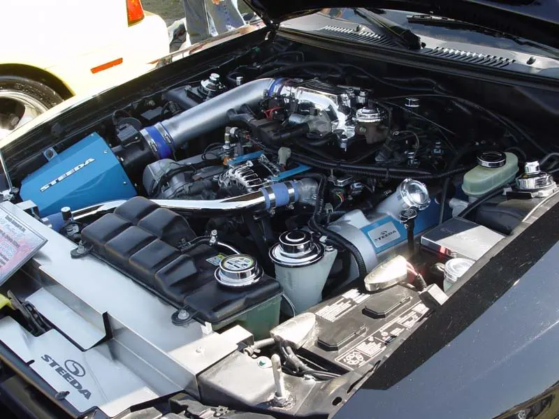

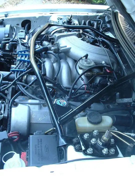

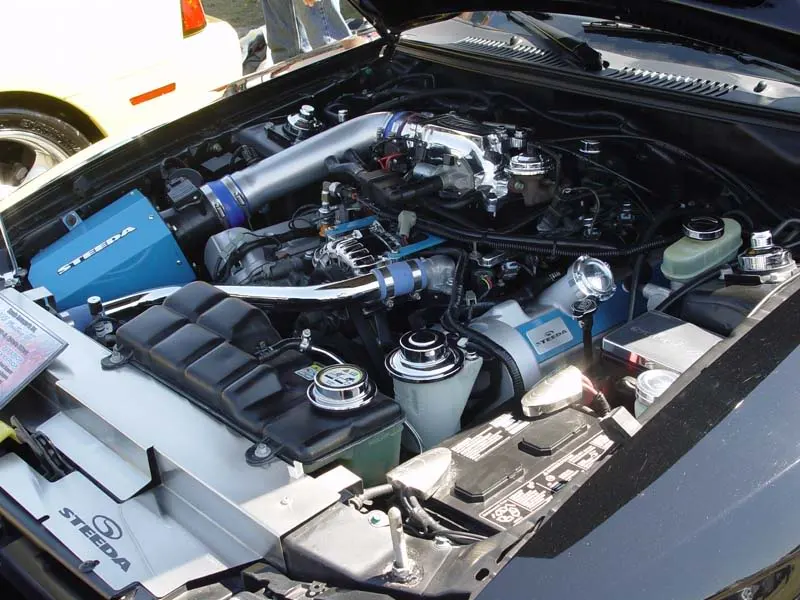

The Team Breeds are the best.

I like those too - hmm I duno what to do now - I got the engine out for another day, and I have to make a quick decision. I got BBK **** on the car so it's no big deal to me if it says BBK on the valve cover. They seem to be nice quality...decisions decisions...
I've installed many of both (BBK and team bread). The BBK's are a pain in the rear to install with the suplied allen cap bolts. The BBK's use a flat gasket that is prone to blowing out and leaking. You have to glue the gasket to the valve cover and carefully try to install it without hitting anything in the engine bay. At the shop we actually charger more to install BBK since there such a pain.
Now the team bread are alot nicer. They use an OEM valve cover gasket. If you ever need to pull the valve cover you can go to any ford dealer and buy new gaskets. They are also just as easy as OEM to install on the car. If I'd ever go with metal valve covers I'd go with the team bread valve covers!!!
