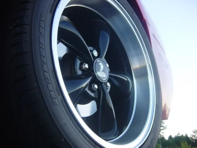

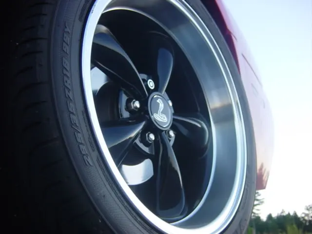

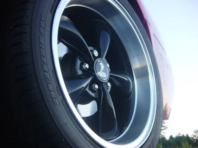

I run 18's all around.
Front rim: 9" - 24mm offset - 5.95 backspacing
Front tire: 265/35/18 KDW II's
Rear rim: 10" - 22mm offset - 6.40 backspacing
Rear Tire: 295/35/18 KDW II's
The rear fits quite nicely but I would think that if I put people in the back seat it may rub. Don't know since I never have anyone back there. I have the same Eibach Pro kit and am using the rubber snub they provided up under the rear end.
Fronts never scraped at full lock either way.
