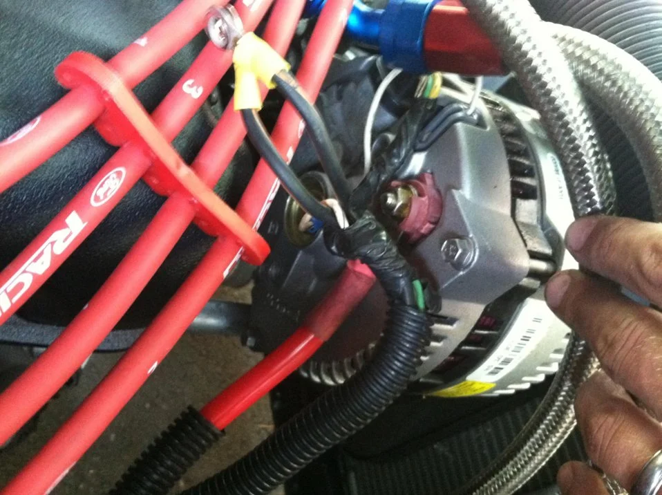

@Noobz347 These are the only wire that ran to my original alternator. I can not find two blk/orange wires that meet anywhere and have a white wire with them. Here's a pic of my alt. wires.
They are in the first pic you posted.
Sorry bout that, I'm currently mobile.
That's fine. I read the threads you shared. They made complete sense except for the orange&black wires. I understand not to tie them to your alternator post. I'm assuming you just tuck them away? I just got really confused when I went to look for the plug and white wire and found nada.
Is this correct? @Noobz347
Yepperz! That's it.

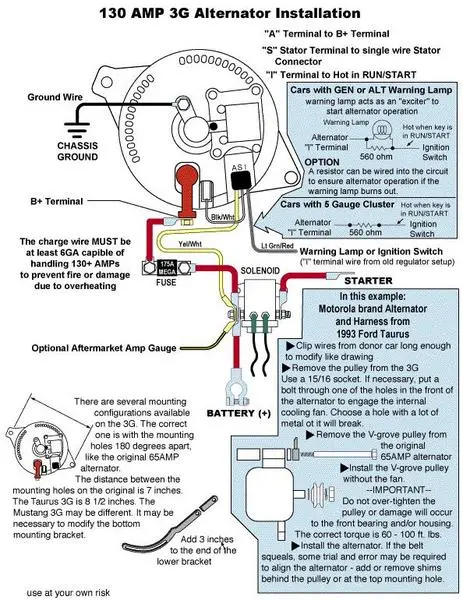

Here's what I've found so far:
In this pic you can see where the poster crimped terminals onto the black/orange wires. That portion is not necessary and potentially dangerous.
It's best to leave these wires tucked away and use the larger gauge to supply power.

Awesome, thanks a bunch! Just to confirm I need the 3g alternator, 3g harness, a spade connector for the white/black wire, 4g power wire, & a big mutha fuse. Then just hook the green wire from the voltage regulator to the green wire on the 3g harness. Correct?
Also, I ran 2 gauge grounds on the car. There is no reason to run a 2g + & - on the alternator correct?
