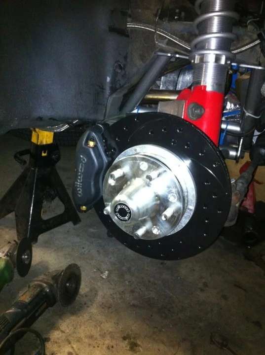

Here is the wildwood kit that we installed on my buddies car yesterday. He has a 1988 coupe. Nice kit and pretty easy installation other than modifying the spindle. Instructions were dead on!!
