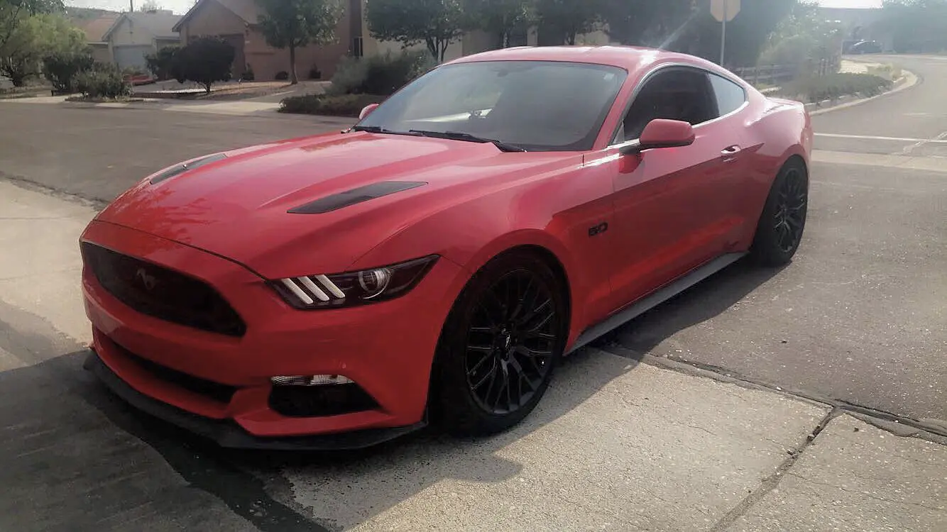

My son got the headers installed this weekend. He has full exhaust on the car now. MBRP, full exhaust with the race mufflers. Pretty good sounding exhaust. It’s a little loud for me, but he’s a 23 year old kid. He likes it. Woke the car up a little more. We also updated the computer to account for them. So far he’s done coil overs, intake and full exhaust. It’s a fun car to drive.
