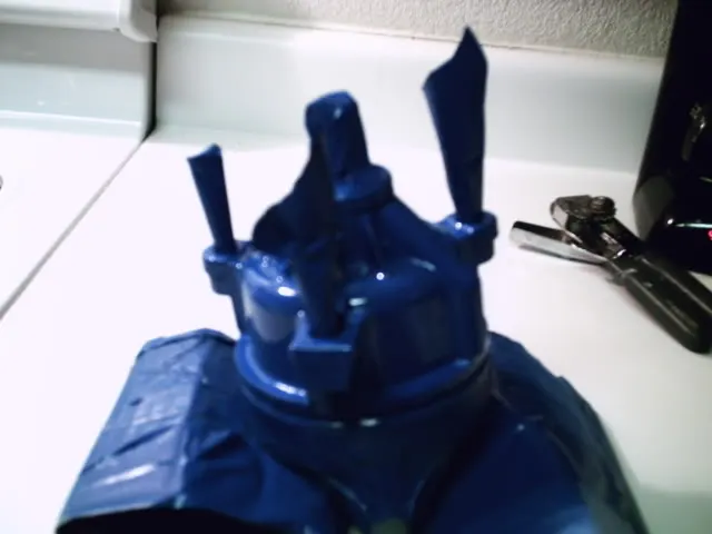

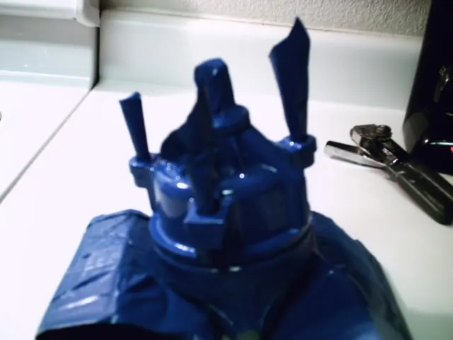

After I masked it off (I had to clean a butt-load of P/S fluid from it, I actually had to drain it, there was quite a bit in it) I then sprayed four coats of paint stripper on it, between each coat I used a burgandy (coarse) 3M pad to get as much black crap paint off. After the last coat was applied I cleaned the part with acrylic lacuer thinner:
I then painted it it with engine enamel (ford blue):
Took all the masking off except for where the pump hole is (oh and cleaned my counter top:nice:):
