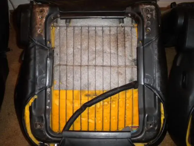

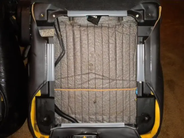

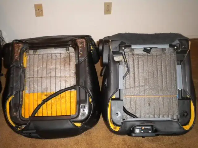

heres a few pics.
passanger side installed already.
what i didnt know was the seat bottom was different than the 94-98 seat bottom.
so i need to go back for the power seat track tomorrow.
old seat on left,new on right
notice how the old bottom is flat.
on the new,the front of the frame is recessed.
