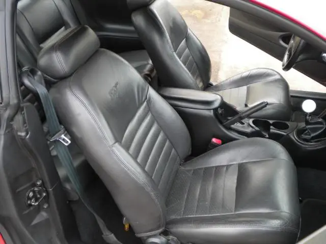

here you go.

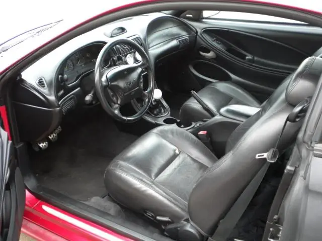

the only thing i didnt like was the fact that i sit alittle higher in the car.
not sure if its the track,or i'm used to my old worn out seat:shrug:
i'll drive around like this for awhile.
if i cant take it,i'll look into swapping out the lower seat frame with one from our year.

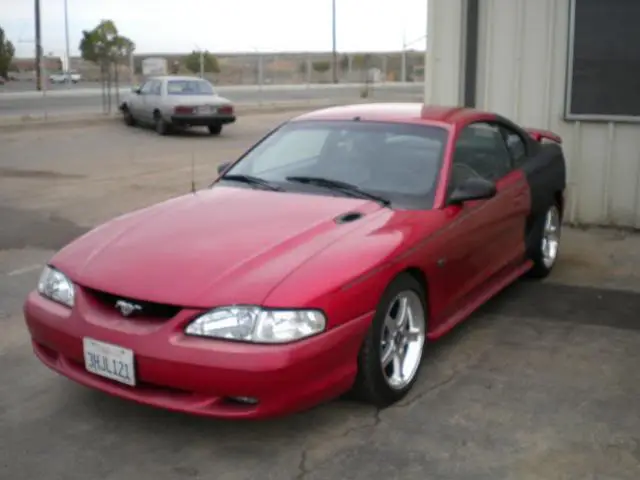

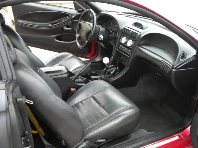

heres a pic of the stang,fresh from the carwash,unfortunatly it rained this evening:(
Tangent: when I put in seat-track extenders, they raised the seat up a good amount (albeit a manual seat track). I felt funny at first but kind of got used to it.
Quick question..how did you mount your A/C control down so low?? That looks different and :nice:!
there is enough slack in the cables to mount it where the pocket was.
you will have to trim the center stack bezal alittle for it to sit flush against the climate control face.
holding it in place is a couple pieces of metal i bent up and attached to the dash board frame.

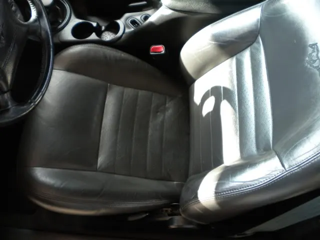

i was quoted $100 to repair that tear in the seat.
the guy wasnt even sure if could match the color:nono:
so i went looking around and found another seat in pretty good condition,if not dirty.
i got it for $85 plus tax which worked out to $93.

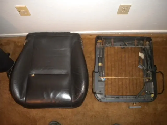

i cleaned it up and put that seat bottom on the original seat that had the tear in it.
looks great,plus i'm gonna sell the other seat and make alittle of my money back:nice:

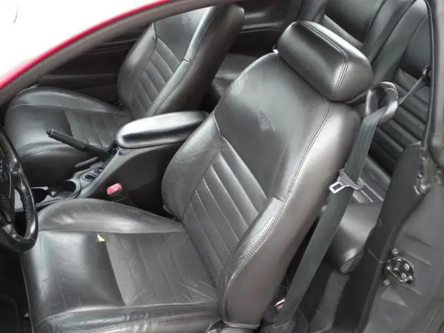

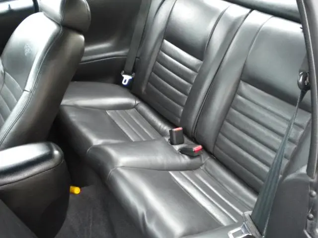

old seat with the good seat bottom on it next to the new seat back
old seat bottom next to frame.
back in my car.
seat for sale.note the ugly headrest.
