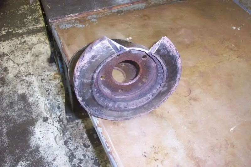

I had that happen before on one of my talons.. The only way to get it off was a BFH...
