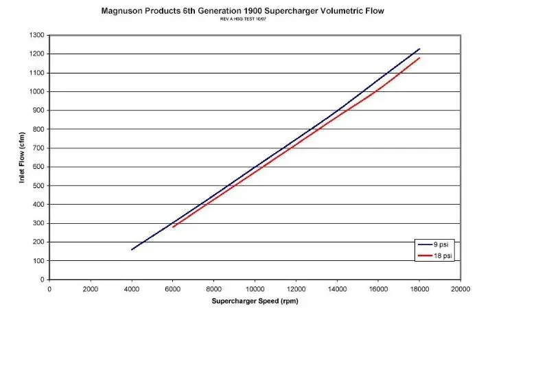

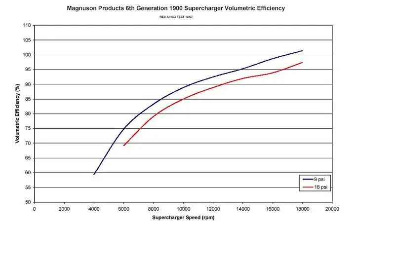

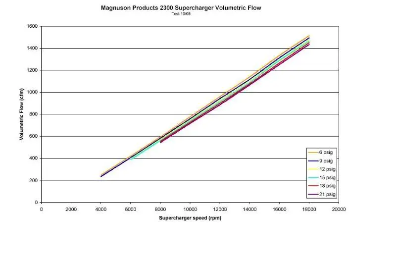

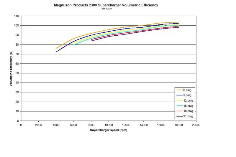

It's not really an eaton, and def not a M112. And assuming roots are grossly inefficient, too, is assuming that we're all using a 4th gen design. Per liter, the TVS's velocity maps and efficiency curves look better to me, i dunno
