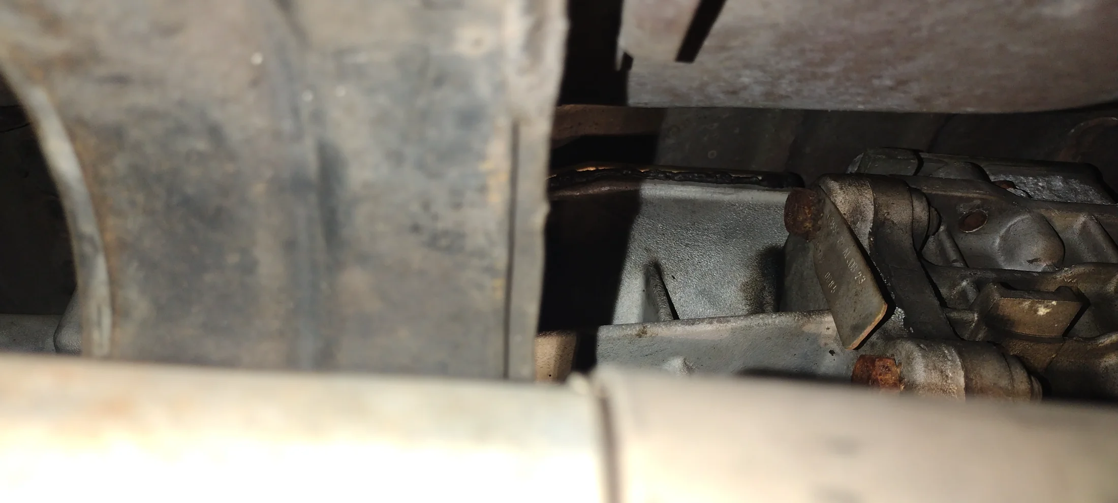

Anyone recognize which trans this is

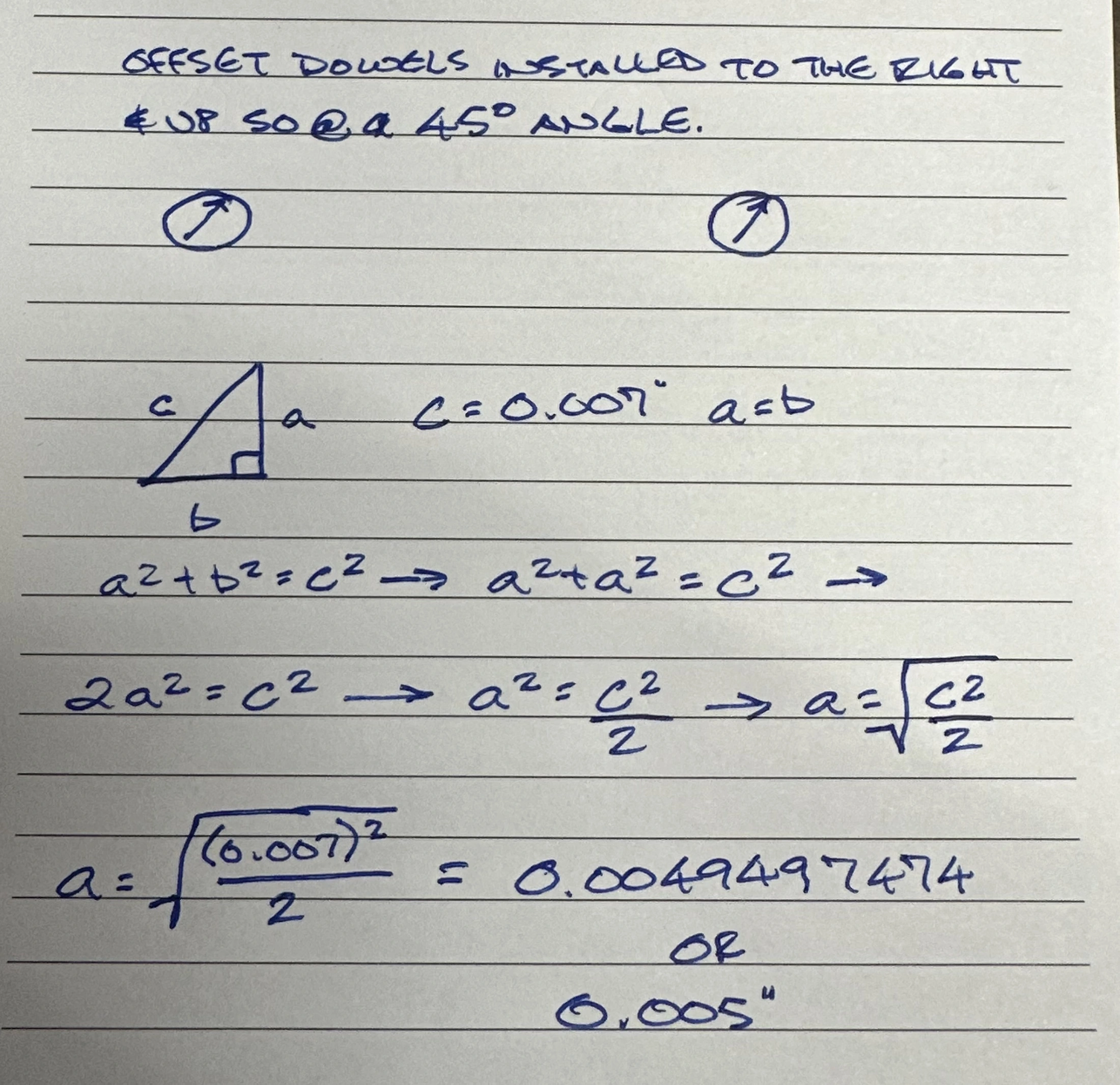

Yes. They are offset in different increments. You have to index the bell housing then order the dowels that get it within the range as specified by the trans manufacturer.
Silversport has two which are 0.007” and 0.014”. They have an Allen head wrench end so that after they are installed into the block you can rotate them to move the bell housing as needed. You want the 0.499” OD dowel pins.

No. The OD of the dowel needs to be 0.499" so it will install into the Ford block. Other brands use different diameter dowels.
The dowel is offset 0.007" to one side. If you install both of them with the offset to the right then it will shift the bell housing to the right 0.007". If you install both of them with the offset to the right and up then you will shift the bell housing 0.005" up and 0.005" to the right. I just text you how I figure this out and I will spare everyone here the math as it may confuse more folks than it helps.

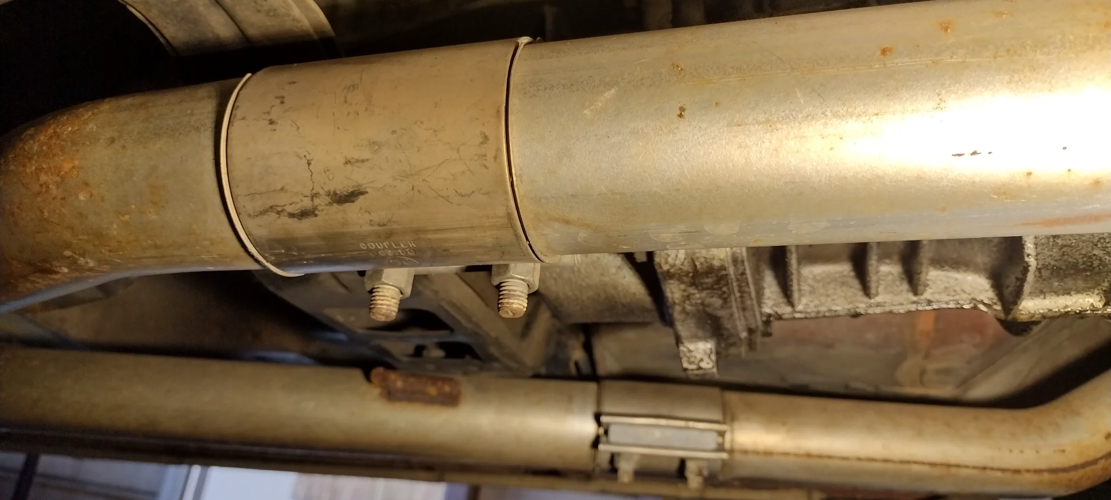

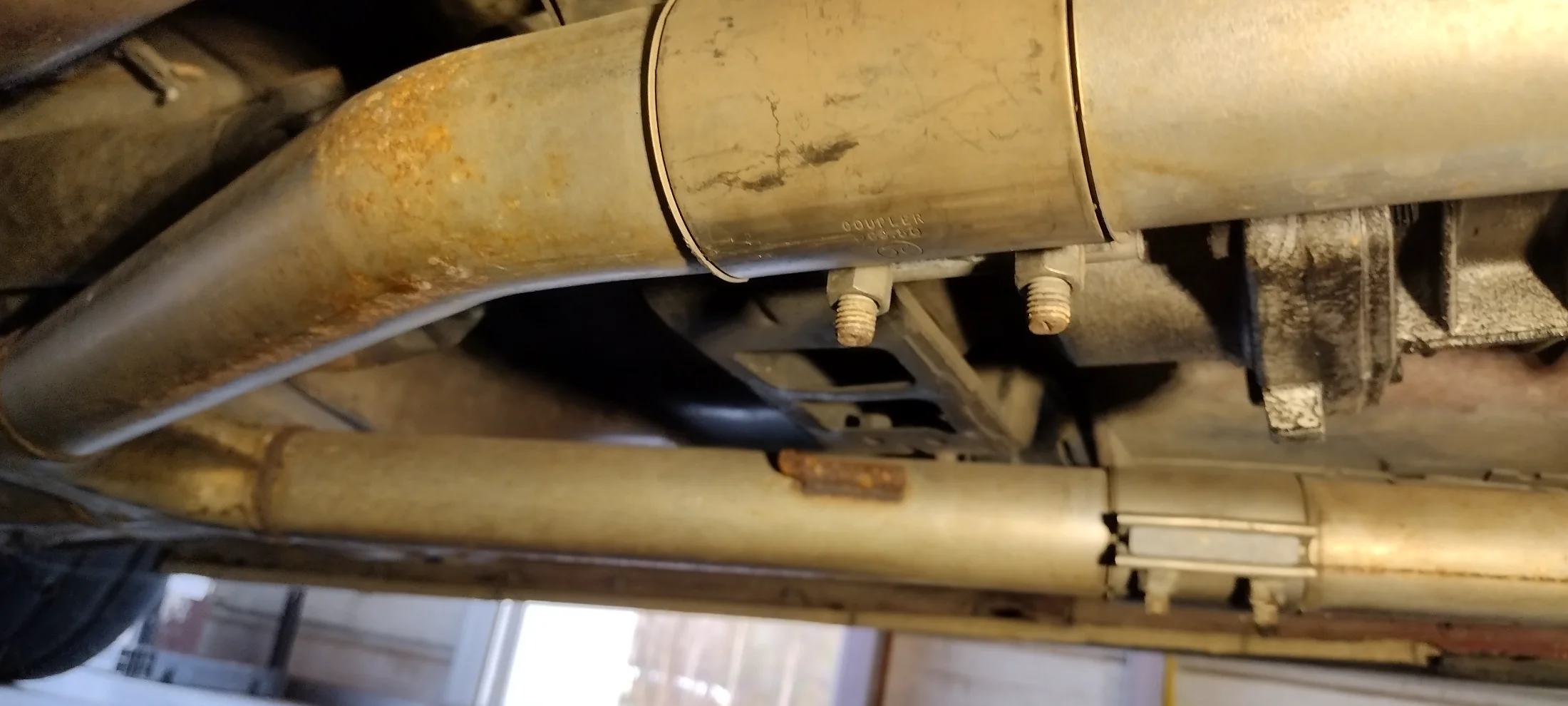

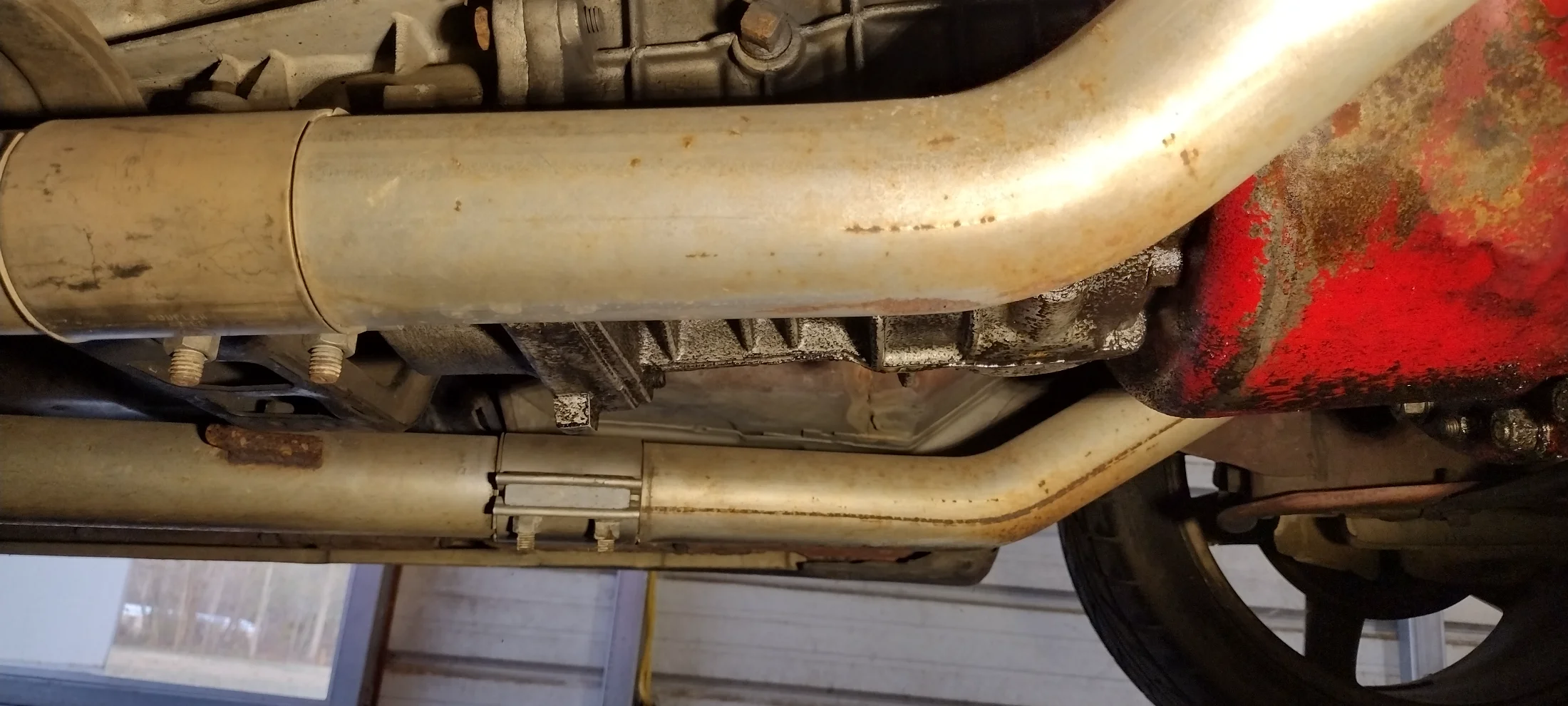

On another note with this X I wonder if the PO had a leak because shorties are on the car and I know it should not have been cut in that area for those band clamps?

BBK built them like that. It was so they could ship them in a smaller box. Mine is just like that. If you see leaks just have an exhaust shop remove them and weld the pipe up.
