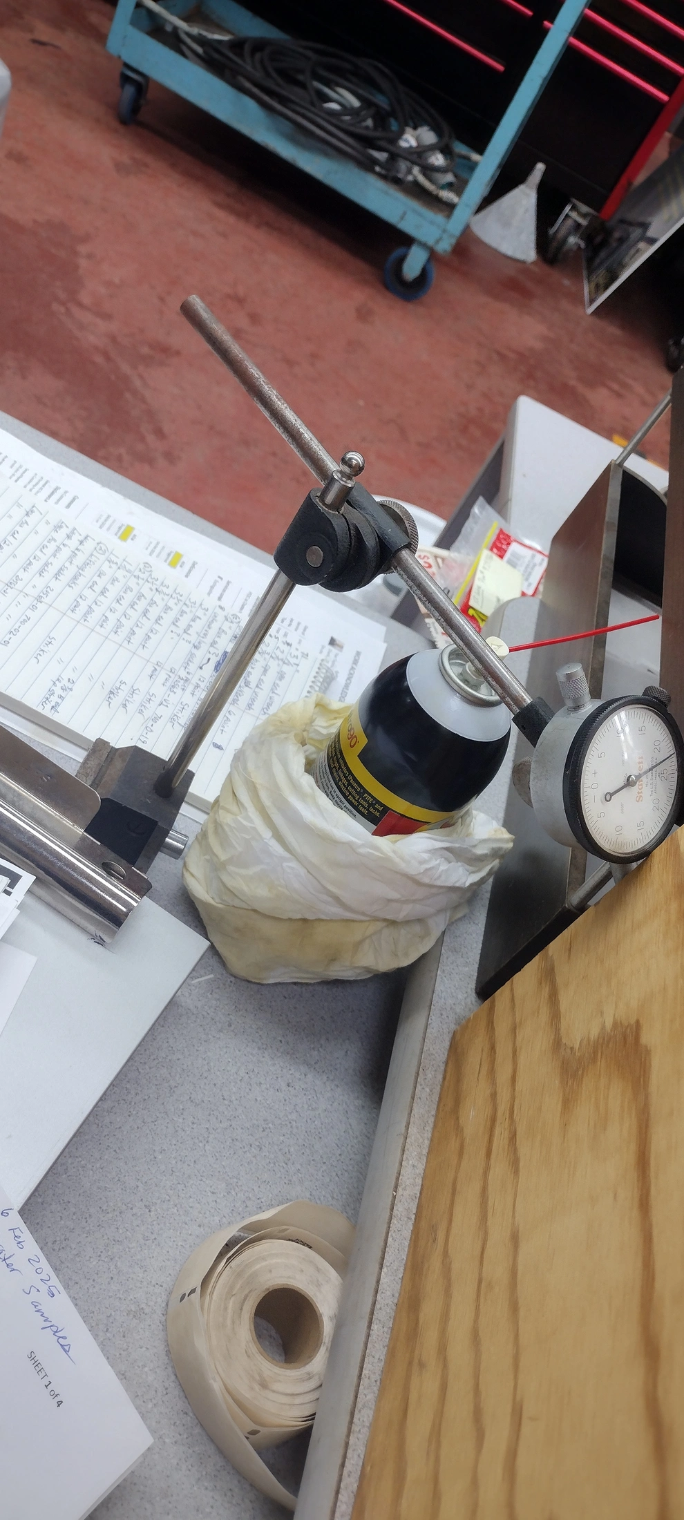

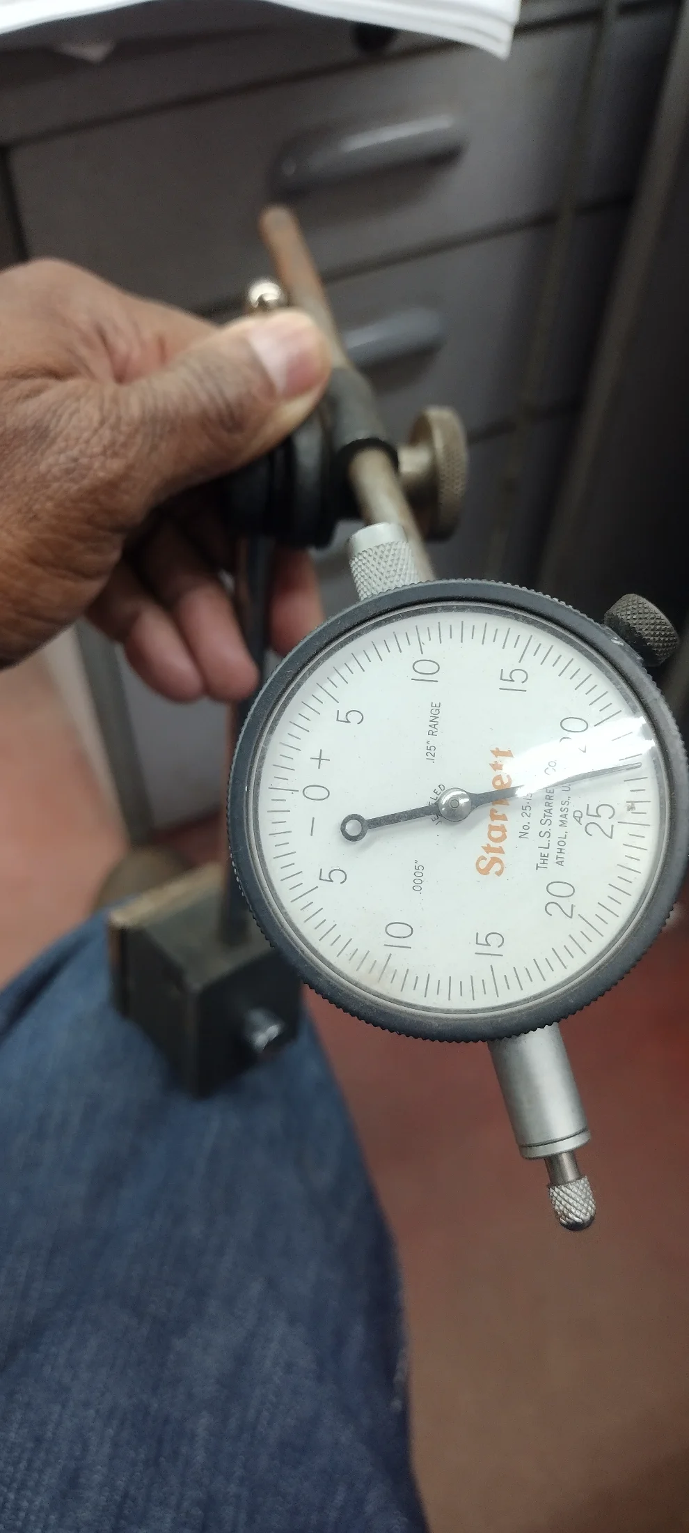

we have some at work.
This is a pic of one. Any specific size needed?
That should work. You end up putting the magnetic end on the fly wheel and get the dial indicator tip on the inside lip of the register hole where the trans installs. Roll the motor over by hand and see how much it deviates from side to side. I usually mark 12:00, 1:30, 3:00, 4:30, 6:00, 7:30, 9:00, &10:30 on the bell housing and then at these locations mark what the dial indicator reads. There are some videos out there that show how to do this.
