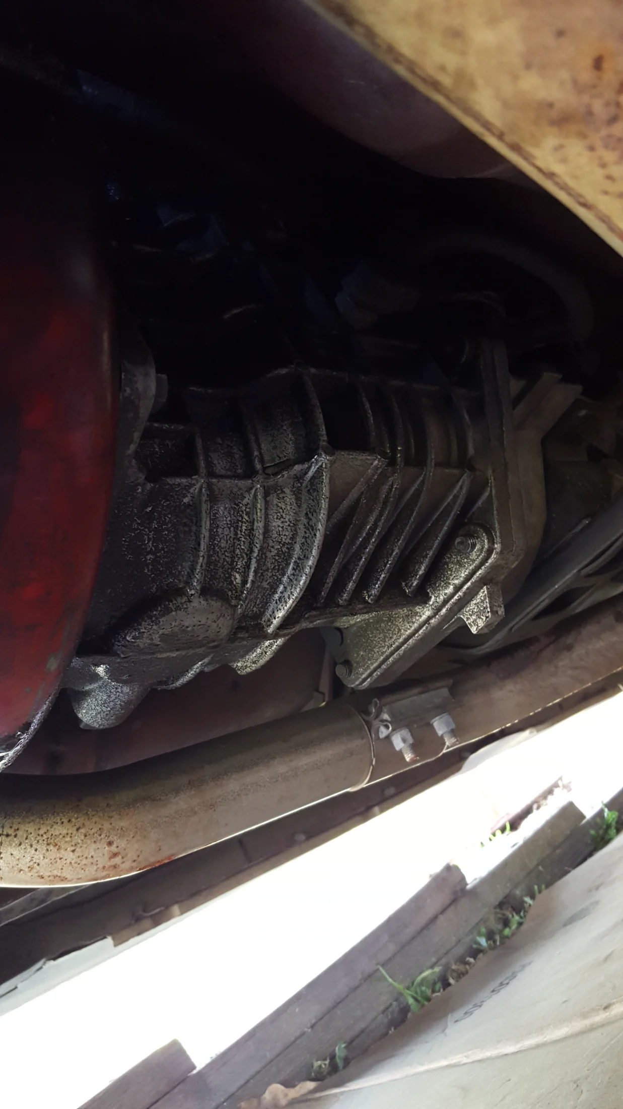

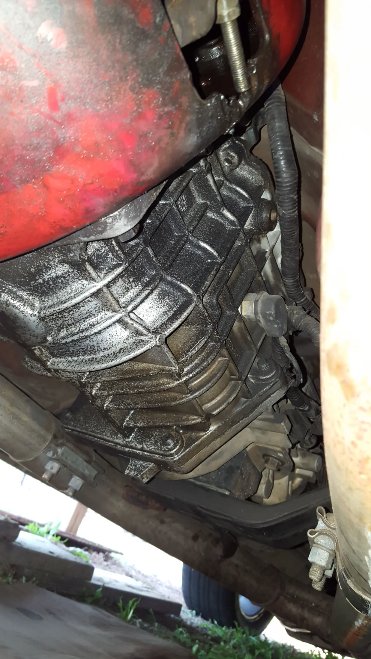

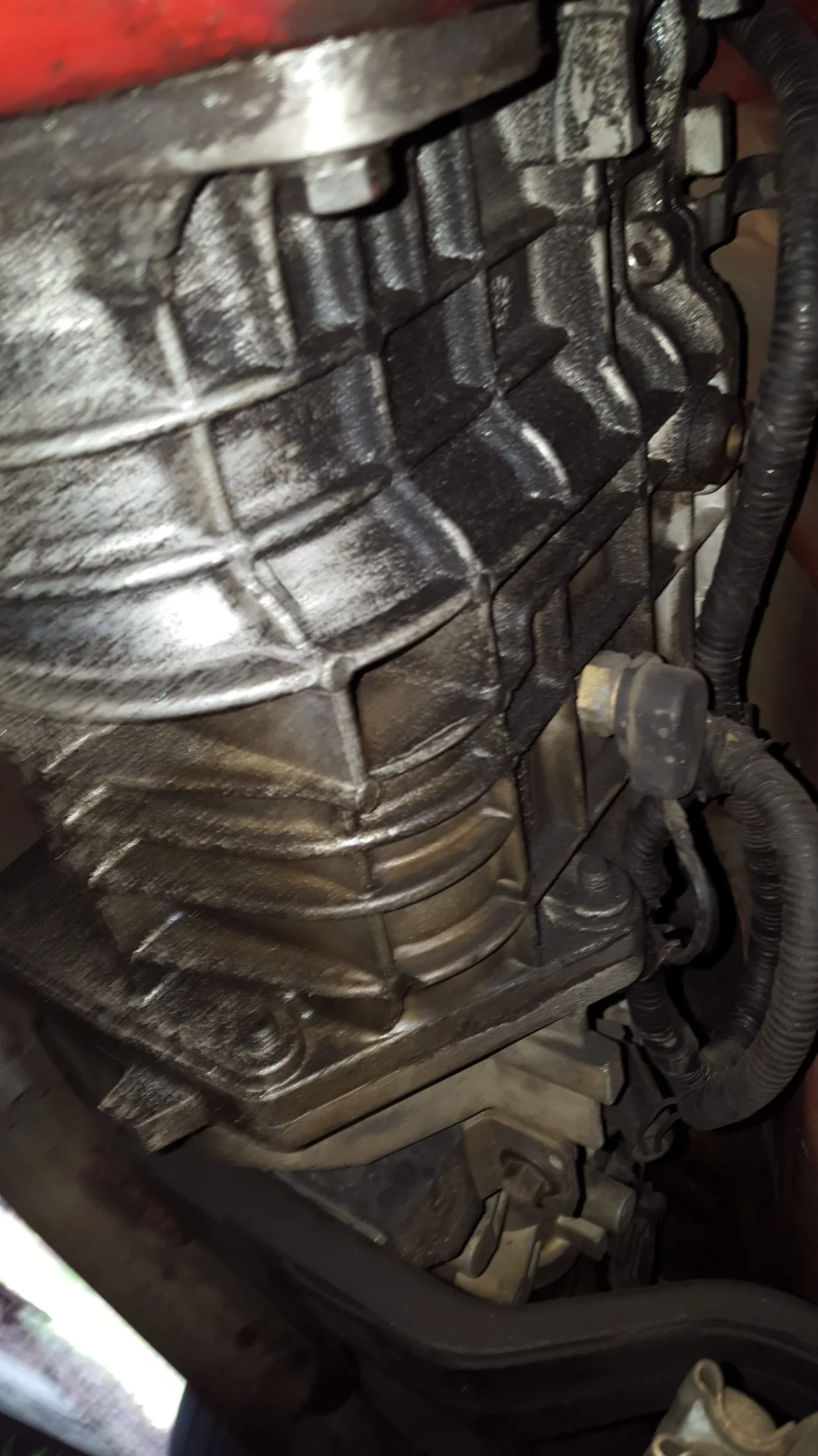

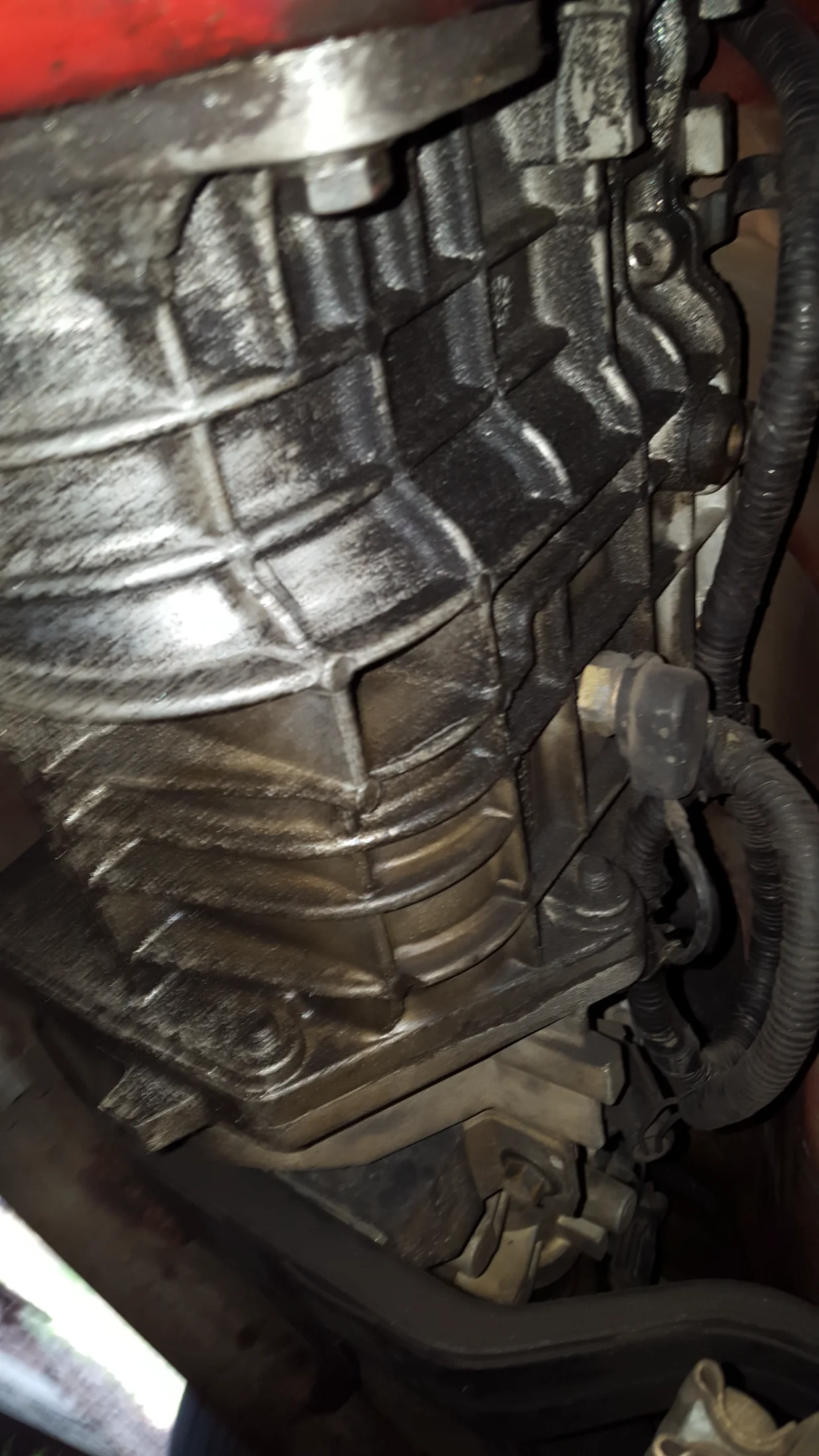

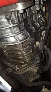

Anyone recognize which trans this is
from6to8
There's suction so I used that end O_O

I'm thinking this is a 3650 or a 3550. It has a Lakewood scatter shield

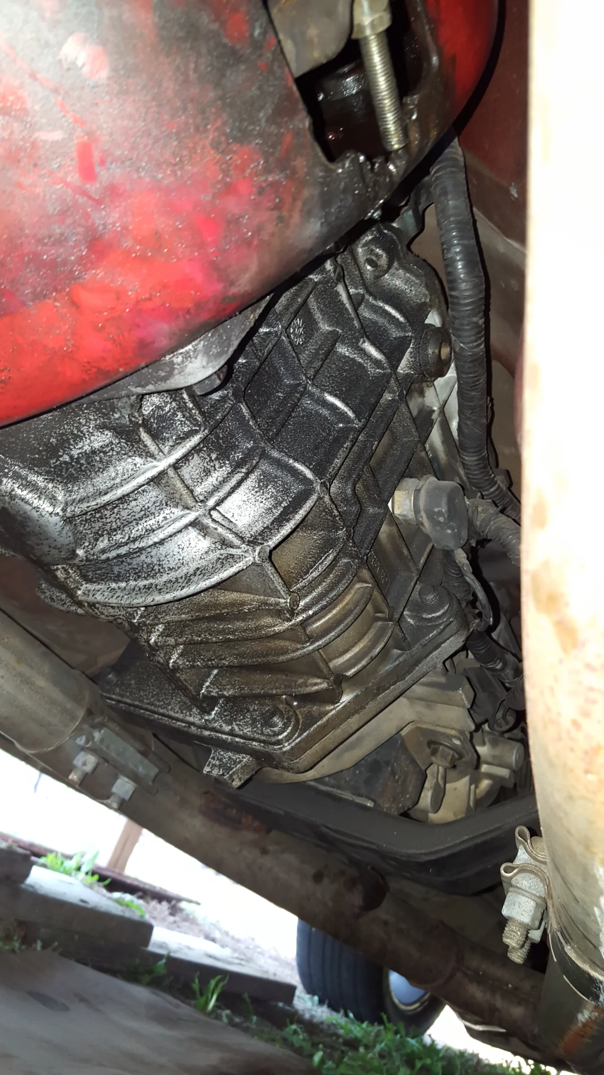

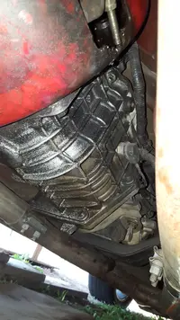

Is that an older Richmond??

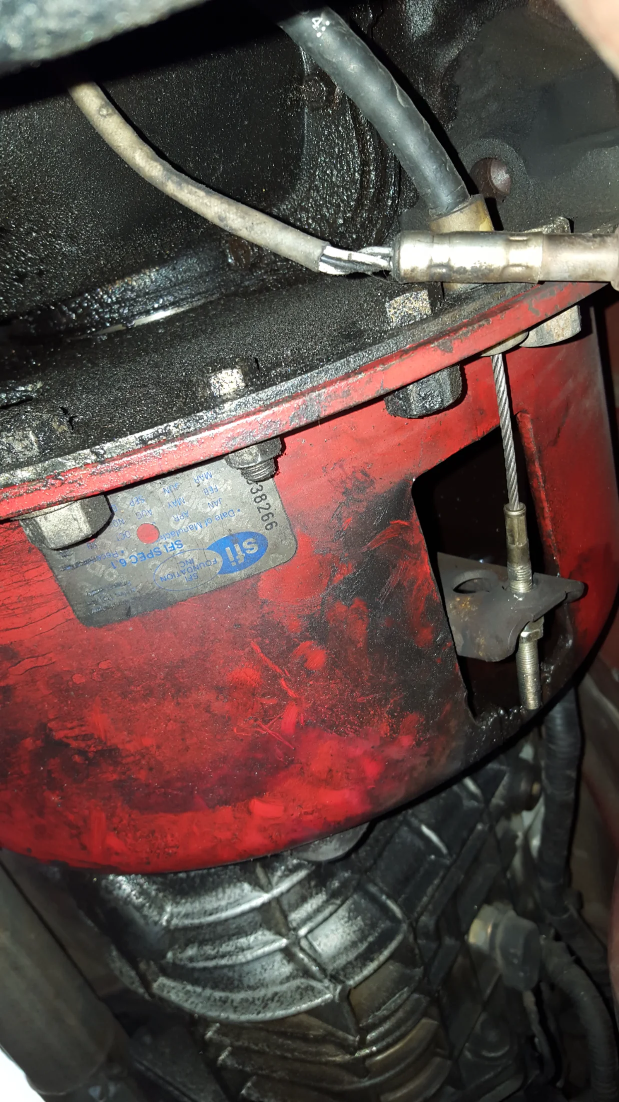

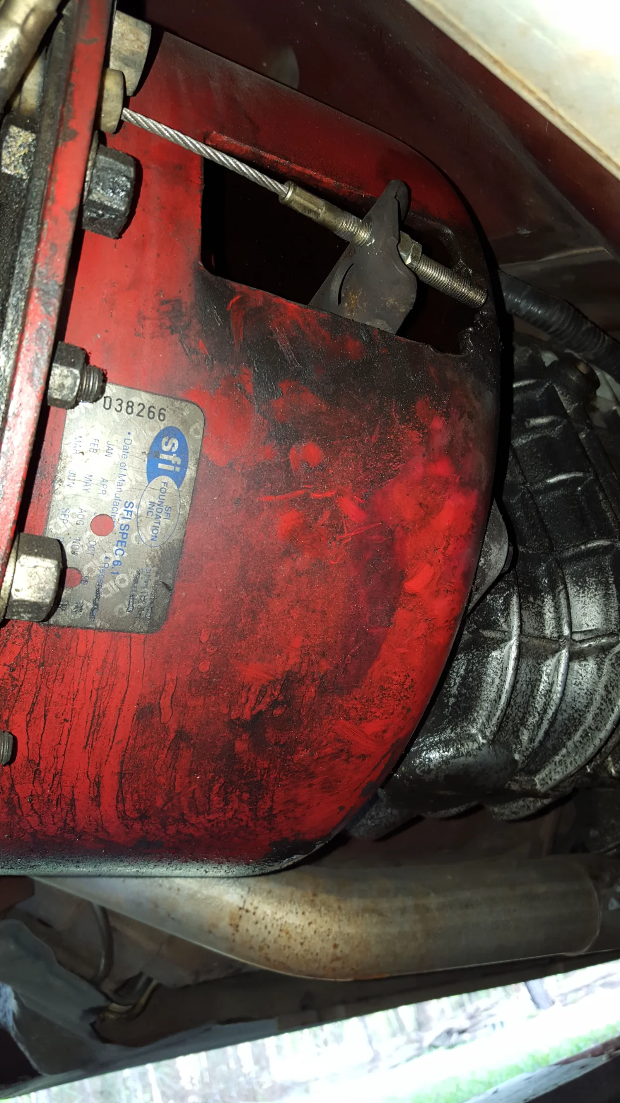

is it easy to find the tag on the trans while in the car to verify the part number on it? I need to find out what it is because i already ordered and recieved a ford performance m 6392 r58 bell on ebay because I was thinking it was a 3650 or 3550. I can send it back if it won't work. I might also think about reusing the lakewood scattershield but I need to find a cover plate that covers the fork.
part number on the bellhousing would also be a pretty good clue.
As far as pattern recognition goes, Ive had plenty of T5s, 3550s, old school TKO, and my T56s and the ribs on that case do not seem familiar to me.
where specifically on the trans would it be, as in while in the car? One guy on the corral said it might be an older richmond I did look at a photo and it could be. I'm just curious if the M 6392 R58 bell I bought would work for it even if a richmond so I need to verify that number on it. It has a lakewood scattershield on now.....

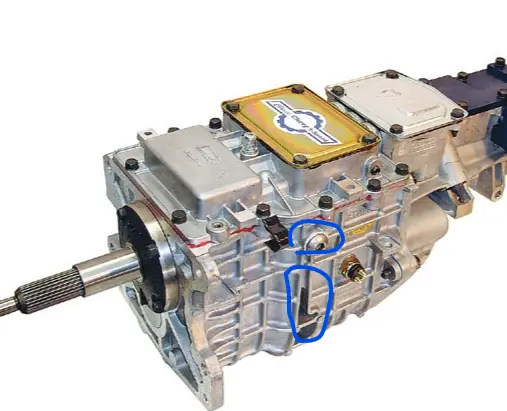

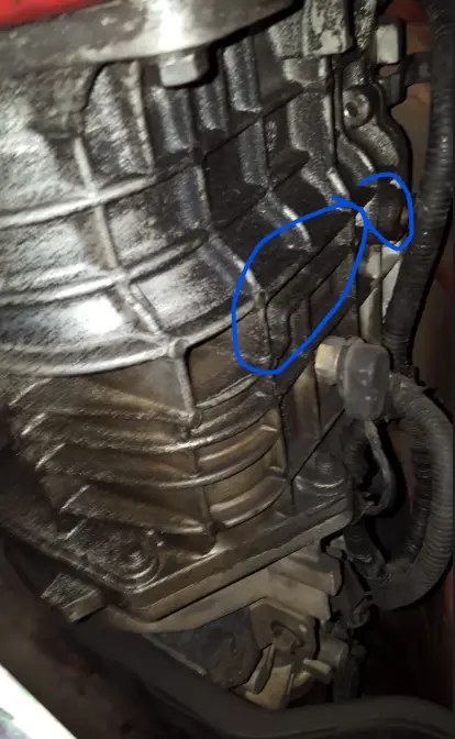

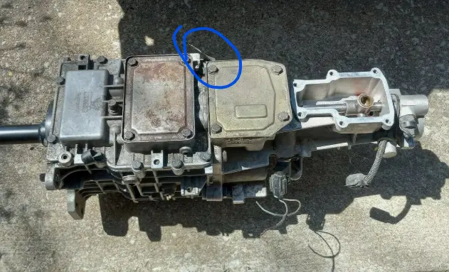

That's a TKO/3550.
See this pic and you can see various features from this angle line up with yours
cool beans man appreciate the help. I'm going to see if I can get to the tag this weekend to verify.
