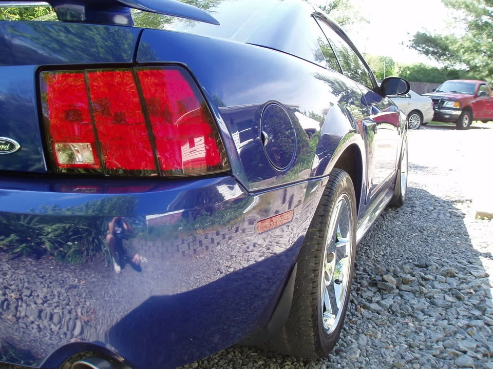

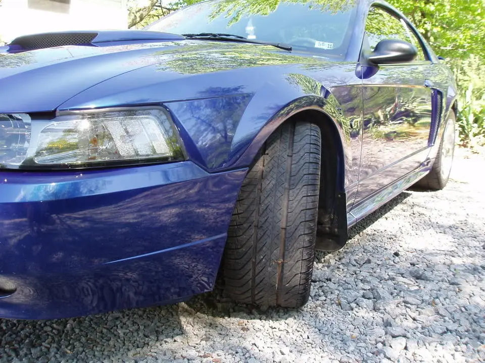

I have had 265/18s (KDW1s) and 275/18s (KDW2s) on my car. Its pretty low now and was slammed before. The 275 definitely rub at full lock and have worn the fender liner. They also seem to track more. I will go 265s next time.

I recommend 265s and 295s on 18x9 and 18x10.
I think the tire has more to do with tracking than size. My tires have NEVER hydroplaned. I have felt tracking a few times, but nothing severe enough to want me to go to a smaller sized tire.
On a side note: took my car to the flashlight drags a Beaver Run over the weekend. They set up the drags on a straight away of the road course. Lets just say my front end stayed planted 100% while cornering at full throttle.:D
