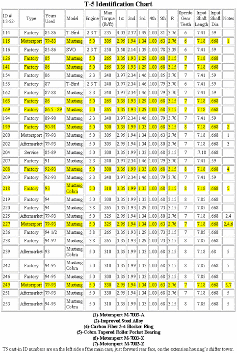

I ran one for at least a year, took it to the track a few times. Eventually it got hard to put it in 2nd but for a daily driver it'll hold up IMO. However I the gears are shorter, at least it felt like it to me, especially 2nd. As mentioned above, you need a different pilot bearing, and the shaft lenght is slighty different. Check the chart.

beyond the strength issue is the gear ratio. you think you have traction problems now, first gear is a 3.97......steeperthan even a stock 3.35......
you also MIGHT not like 5th gear as it has a.79 5th instead of the .68 of a standard t-5. ( all this listed in the chart above)
