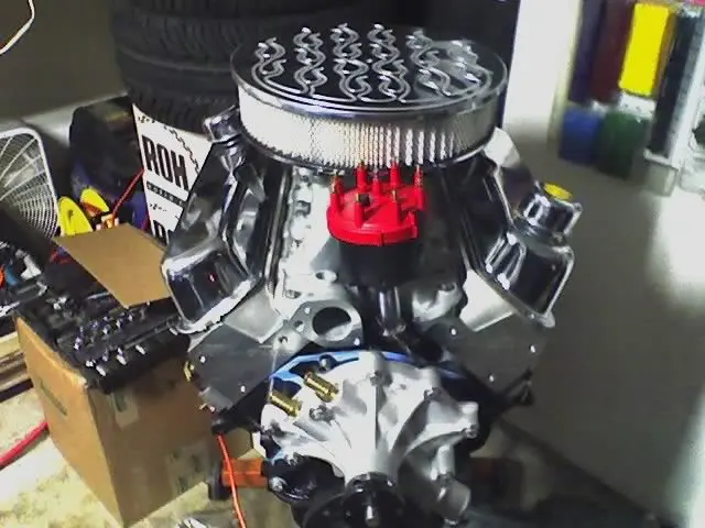

Thanks again for all the help.. made a little progress last night. Im changing out the valve covers, and just have a few odds and ends to tie up before i drop the motor in :D

Make sure you check distributor shaft play or you may have an oil pump shaft that is a touch too long and screw up that nice MSD distributor. Ask me how I know.:nonono: :bang:
Oh and by the way looking real nice.....
We checked it before we put everything on it.. A guy that was helping me told me not to use that little washer on the shaft, then i read someones post here about it coming out with the dizzy... so we took the shaft out, installed the washer, installed the dizzy, and checked the shaft.
