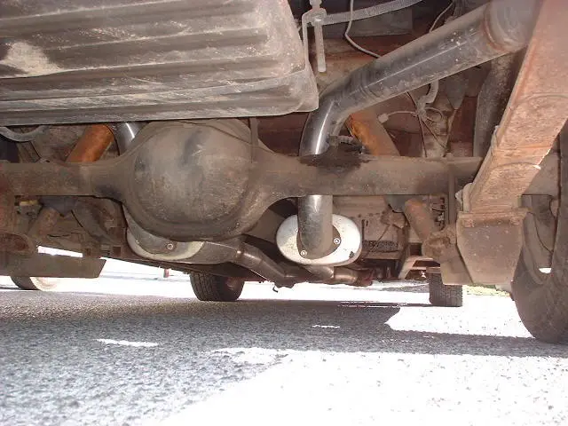

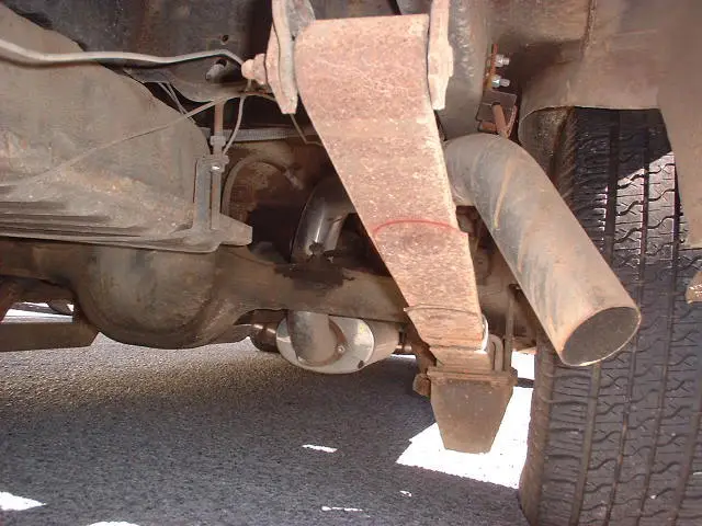

From experience, a belt sander is our friend for setting up but welds on exhaust. Did 3" stainless from the headers back on the ranchero, hand fabbed the X pipe and even went over the axles and out the sides. Note the header flange behind the magnaflows. Makes future work so much easier.
Even a "stock" SD 302 sound mean through 3" and Mags
Enjoy,
Jamie
