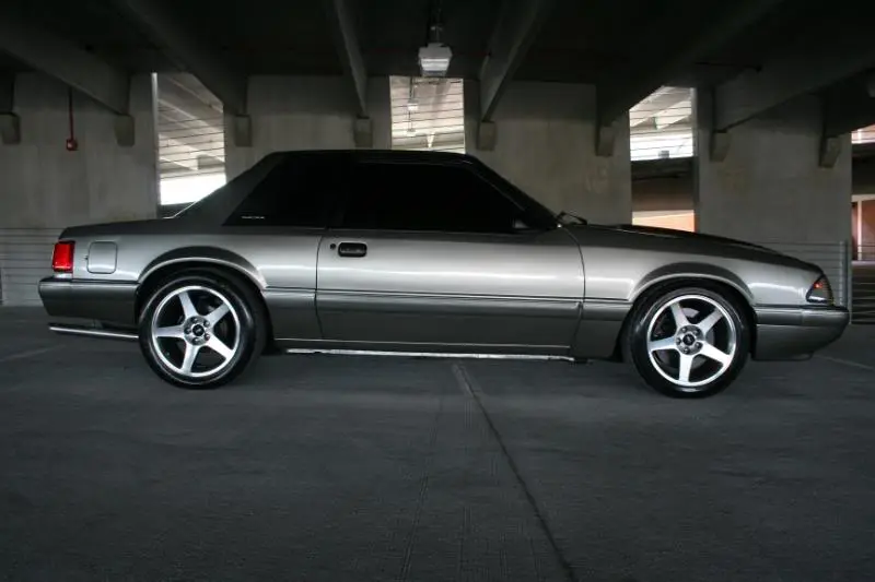

not mine I dont know whos it is just a pic to see

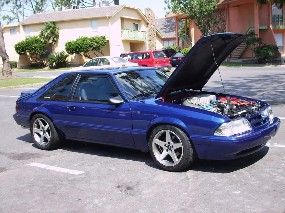

I'm running 255 tires all around with no issues but its stock ride-height. I did roll the front fenders and beat the inner rears, they don't rub on the street but on the road-course I could get the car leaning enough to rub, still nothing serious but I wanted the problem corrected. They will fit and having a 9" wide rim opens up some wider tire options especially for the rear where I previously ran 275 tires with no issues.

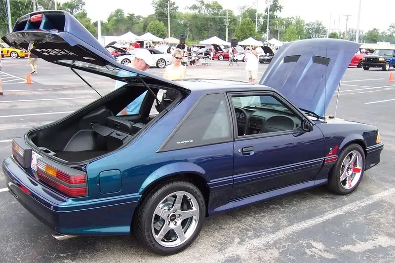

275/40's in the rear, and as previously stated no real rubbing issues after a fender roll and rack limiters in front. I can get it sliding enoug to leave rubber on the exhaust though...
