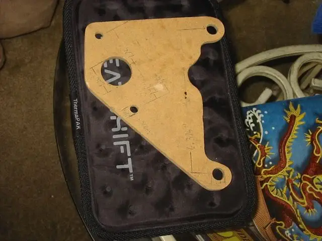

Here's a pic of the hardboard template/prototype as I don't have any finished pieces that aren't installed or sold.
Pushrod=3/8"-16 stainless threaded rod. The first I had was from DazeCars, but it was too short. I used his stainless ball. Not sure where to get a ball except to buy a cheap 3/8" heim joint and cut the ball out of it. Or maybe McMaster-Carr. The clearance is a tad tight between the bleeder/line fitting and the tunnel but it just makes it.
