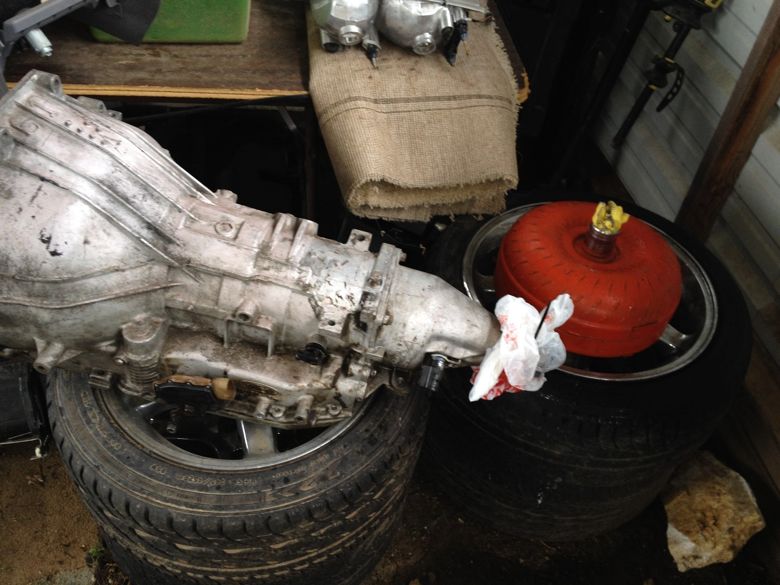

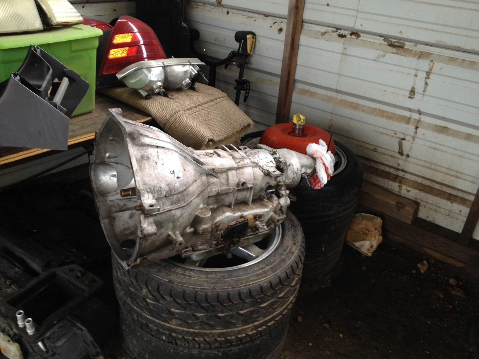

and here's a few pictures to make this thread more interesting. everyone likes pictures.
