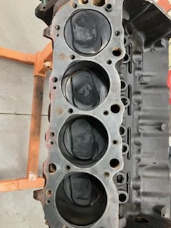

I found another block with pistons I may use because the pistons are still good and the block still has crosshatch marks
You guys know that a 427 is a 396 crank in a 454 right? Like a 283 crank in a 350 makes a 302 chev right?
