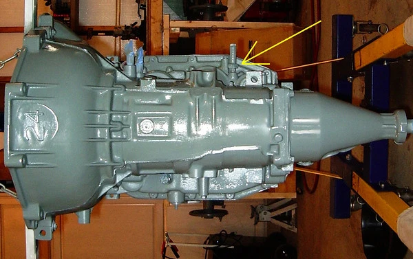

I'll bet the TV cable isn't set right. The proper way is to get a gauge and screw it into the test port and set the pressure to what is recommended. Not only will it cause poor performance if it isn't set right, but it will damage the tranny in record time.
adjust the pressure???? test port on the AOD??? what!??!?!
There is a cable that has one end connected to the throttle body and the other end connected to the side of the tranny at the shifter lever. This cable controls the throttle valve pressure (TV pressure)... it has an ajustment at the throttle body end on the throttle cable bracket. This pressure must be set using a gauge that screws into a port on the passenger side of the tranny. (see pic below, yellow arrow) There will be a screw in plug that must be removed and an adapter with the same size threads as the plug on one end and a nipple on the other end. Put a hose and clamp on the nipple and the gauge at the other end of the hose and then set the pressure using the directions as shown below.
