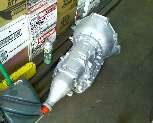

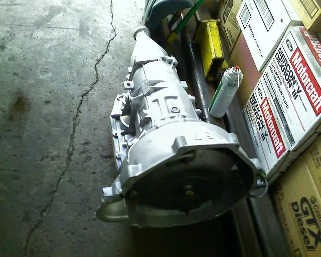

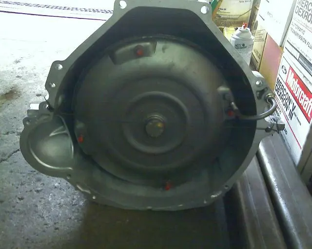

the AOD was installed today. i don't know how it went yet because the last time i talked to my mechanic, tony, he was still working on it. he said he wasn't expecting any major issues though.
impressions and more pics tomorrow:

Tony just called. He said this:
The shifter cable bracket for the AOD is not part of the tranny, it is part of the cable assembly. Apparently, the cable assembly costs $200 from Ford, and if you use that cable assembly, it is not compatible with the shifter I have, which came from a 99+ car. Also, the compatible shifter is no longer available from Ford, so we would have to get one from a junkyard. But he has other jobs he has committed to, so he doesn't have time wait for it to be delivered. So he said he will have to fabricate a bracket and figure out a way to make it work, because he needs to get the car out of the shop by Monday.
He also said something about the way the torque converter attaches to the flexplate. I think the AOD converter has studs on the converter, whereas the Edge converter is threaded for bolts, so you need nuts to attach the AOD one to the flexplate.
