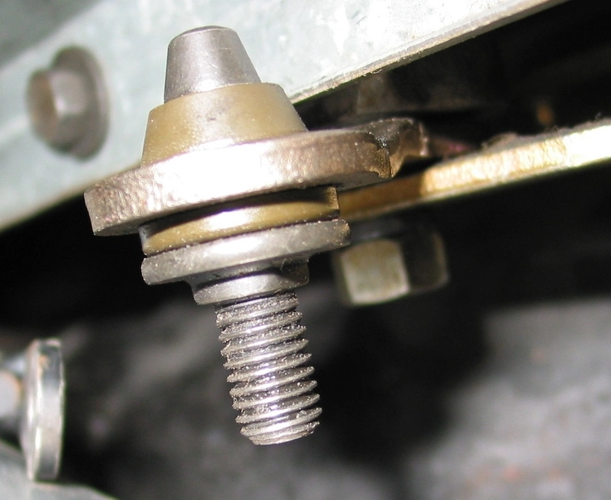

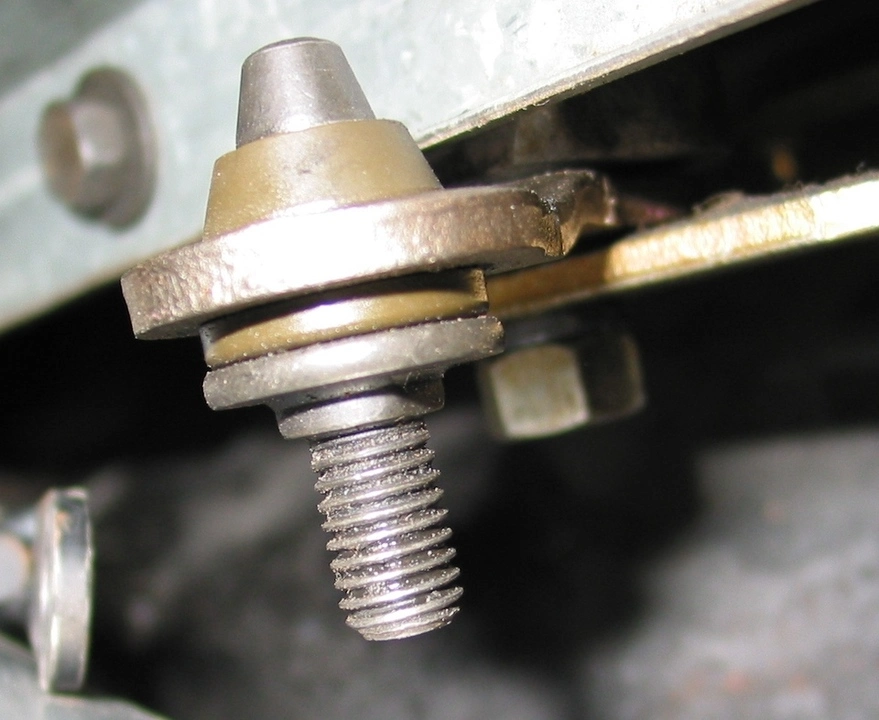

Okay, first off the Ford peice CAN be swapped 180 degrees to point upwards, and it CAN be done without removing the valve body or the filter. Pointing it upwards which fixes the shifting pattern from the factory (1967) shifter that I have connected to the AOD with the Windsor-Fox linkage. Looks like the selector shaft and link that PA sells is designed to use after-market shifters and avoid having the factory "thingy" pictured here
that thing cannot be removed from what I found and that explains why PA sells shafts that just have a hole instead of the weird captured bolt.
Anyhow, the shaft now points up and although the TV cable would have worked fine also pointing up when the AOD link pointed down but...THEY CANNOT BOTH BE UP. There's obvious interference between the two. So I'm going to have to use it downwards, with the cable coming out to the rear, which means I've cut mine too short...sigh. I think I can go to a bike shop and get a new cable with the sheath, all the other Lokar parts are fine.
