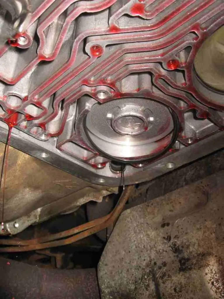

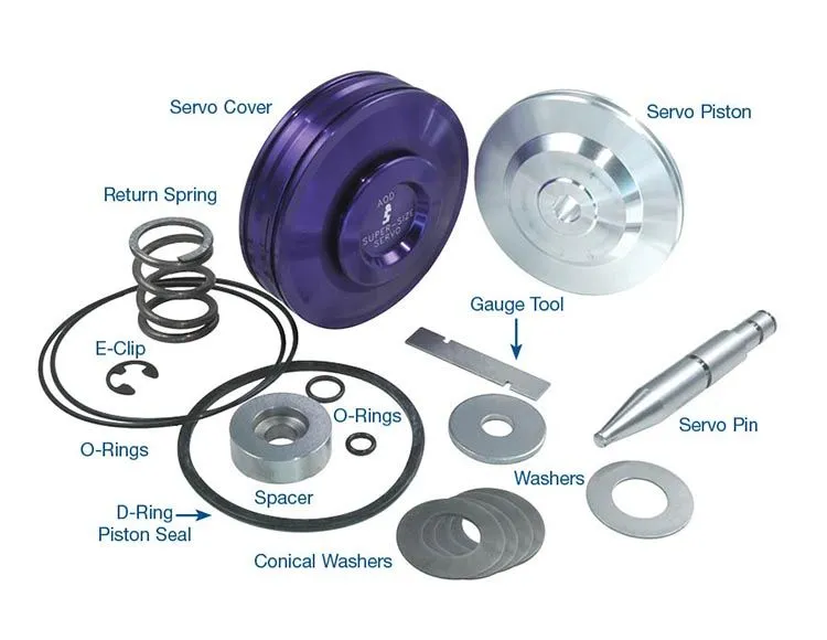

Sonnax makes a "Super Hold Servo" that is supposed to fix the problem. The 1st AOD that I had torn apart, the OD valve was cocked to the side. It was bad enough that it started to strip the snap-ring groove.
I dont know how serious it is, but Sonnax claims to have better snap rings? I bet that the OD servo is cocked to the side in this pic...

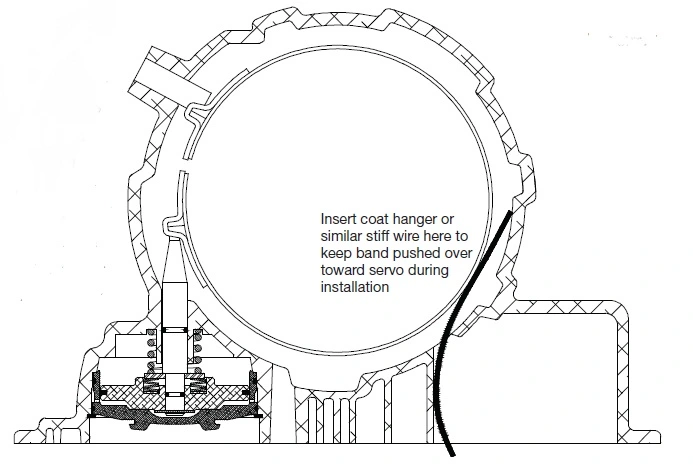

Also, it could be from a rebuild and the person didnt seat the snap ring properly. These servos are hard to install by yourself. The first one that I did, I had my wife push on a broom handle while I seated the snap ring.

We're gearing up to drop the pan and valve body to have a look at the servo and maybe upgrade it in hope that it will solve the problem.
