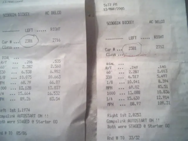

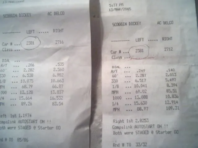

my 95 cobra was slow my first trip out almost no traction and it was sluggish I tuned it up but still only ran a 15.6 @89mph our da that day was 5300' :D

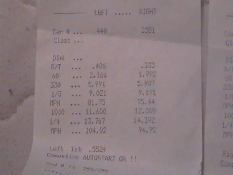

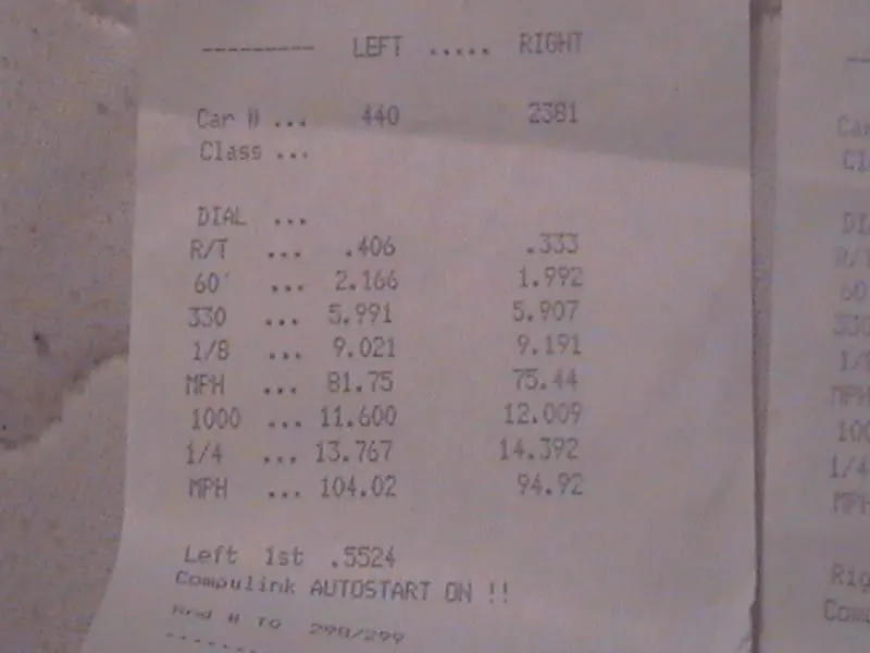

now I have bumped my timming up to 14º added bfg drag radials mac shorties pullies 3.73 gears and ran a best of 14.39 @ 94.92mph I have cut more than a second off with bolt ons ... around here the 94 to 96 gt;'s run 16.1 to 16.8 with stick and auto's , our elevation is 3281'
in this race im on the left on the right is a 1996 gt auto with bogarts slicks with 4.10 gears ... and on my best pass was against a 2001 ss with bolt ons

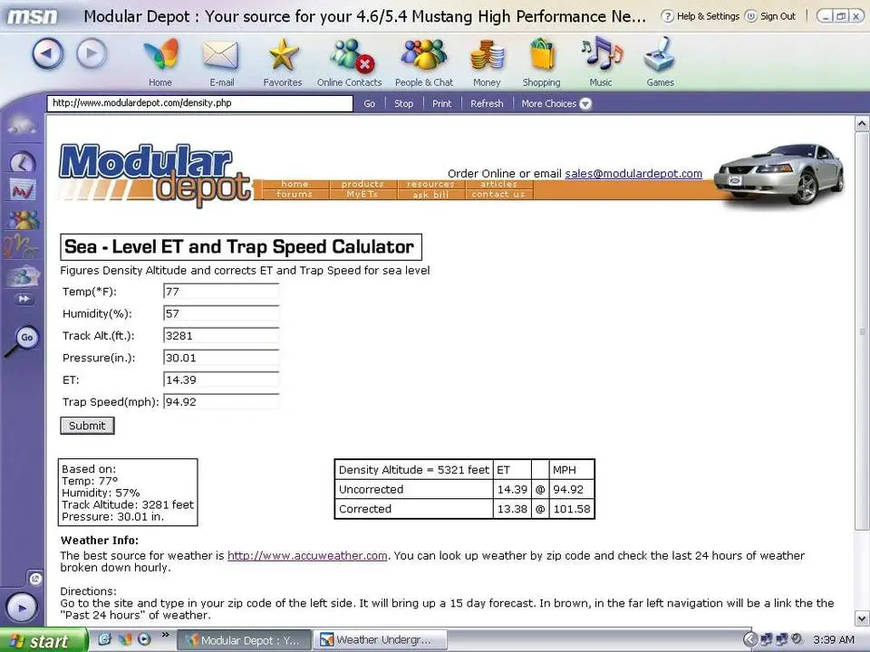

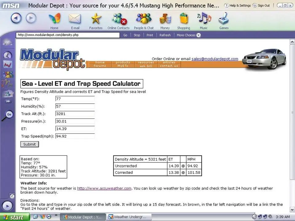

yep it kills mph pretty bad most of the time the da is over 5000' so in march when I ran a 15.6 at sea level it was a 14.6 at 95mph now with my 14.39 @ 94.92 would be a 13.4 at 101mph I cant wait for a cooler day ...
:bang:
