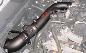

Here's a basic idea of how a full cold air intake is routed...
Everything connects together real easy with hose clamps. With your kit, you'll probably have a rubber sleeve that fits over top of every connection, and you would use two hose clamps per connection, one on each tube.
For example.. intake to tube1, connect with rubber sleeve and clamp both the intake side and tube1 side, then tube1 to MAF, then MAF to tube2, and that tube2 should go into the fenderwell where it attatches to the filter somehow.
This can't be too hard to figure out dude, just think about it for a minute.
If this isn't a fenderwell kit... well then, there's no excuse for you to not see how it goes together.
Yea its incredibly easy and kind of self explanitory if you lay all the parts out in the same basic shape as the one in the pic above and see where the MAF goes between the two pipes. Just remove your airbox and its really basic stuff. I had a bracket in my kit that held the maf I had to install but yours might not have that. Good luck dude.
