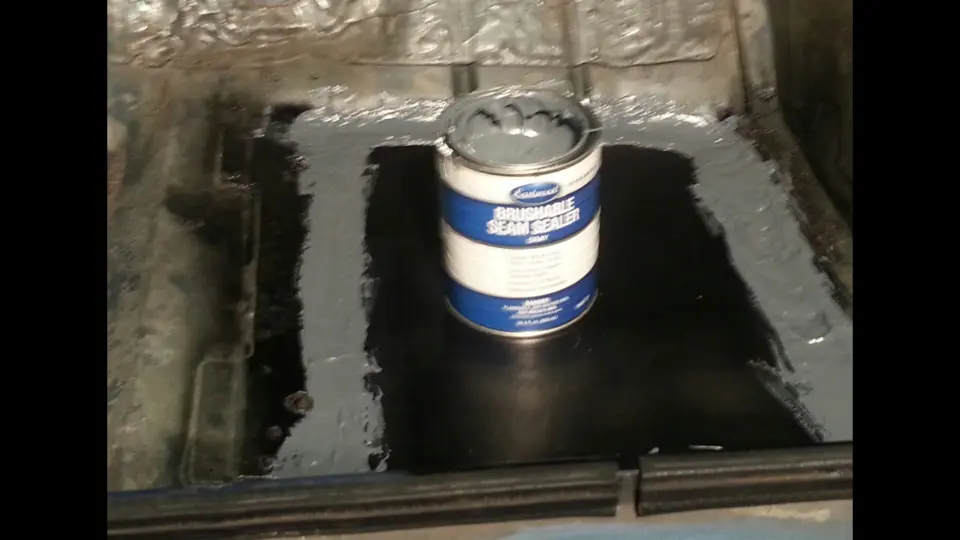

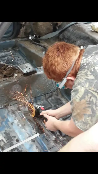

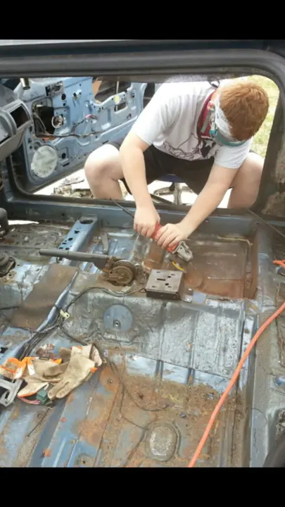

Killing floorboard rust..
Boosted92LX
Dec 19, 2010
5,721
4,244
224
Feb 12, 2015
#64
  • Feb 12, 2015
  • #64
Cutting out a spot to patch..
Reactions: A5literMan
Boosted92LX
Dec 19, 2010
5,721
4,244
224
Feb 12, 2015
#65
  • Feb 12, 2015
  • #65
I cut out a patch panel and welded it in here. Tried to weld it in here, actually. I used new 16 gauge for the patch. The old floor pan was so thin tying the patch in to it felt like 1/2 plate next to sheet metal.. and I'm not a bad welder. I really didn't want to cut the entire pan out, so, I stitched it in there trying not to blow too many holes and my son painted and sealed it up with this stuff:
Eastwood seam sealer. Works like a champ. i highly recommend it for hard to reach panels or stuff too difficult to seal weld.
We are going to do the front pans this weekend, hopefully.
Reactions: hoopty5.0 and A5literMan

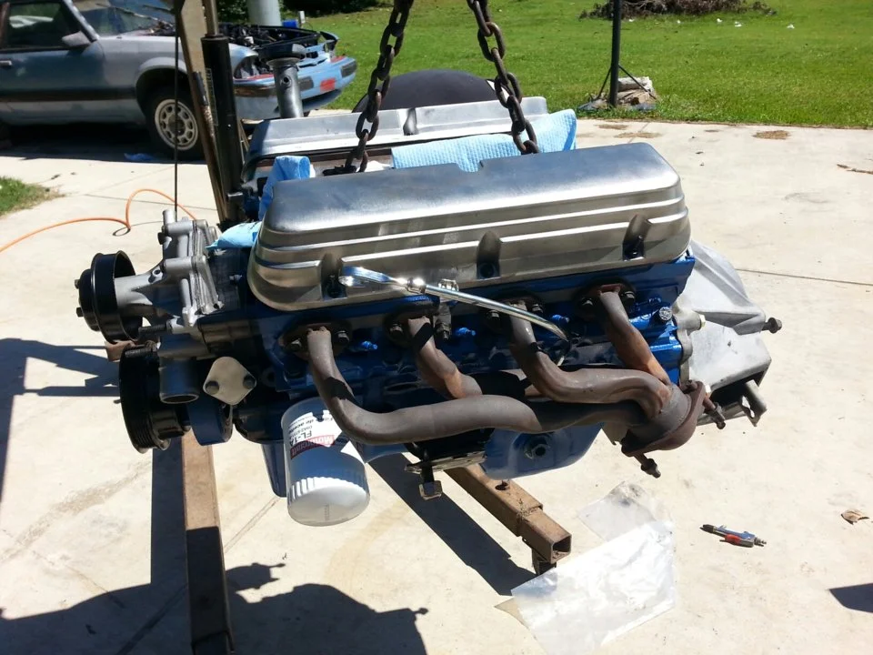

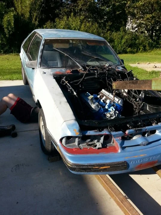

SCORE! I was over at My buddy's house last night to pick up a part for a member here, and was voicing my despair over losing all of my pictures of this build, when he got an odd look on his face. "Come with me", says he. We walk into his home office, and on his desktop is a file with all of my pictures! I had texted them to him, and he backed them up. I gotta take back fussing about his camera ability, because man, this fella made my day:
Boosted92LX
Dec 19, 2010
5,721
4,244
224
Feb 14, 2015
#76
  • Feb 14, 2015
  • #76
Reactions: 89oem, A5literMan, TOOLOW91 and 1 other person

So wait... all of those pics were reduced in size enough to be texted?
Those are pretty damned good looking photos for being texted.
I'm pretty sure I texted them to him from a Samsung Note II. I don't recall emailing any to anyone. He dropped em on a thumb drive for me and I downloaded them to my desktop.
02 281 GT said:
It doesn't get any better than that.
Quick question: what dipstick is that? Mine is all banged up from being twisted around through two header installs on my car and could use replacement.
Late model resto chrome 302 dipstick.
