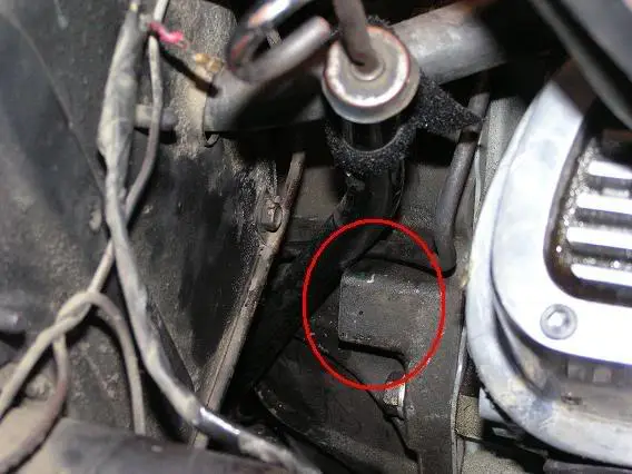

The bell housing was my original thought also, but the tab is about 2" away from the nearest housing bolt. I've tried coming in from both sides of the heater hoses - from the driver's side the angle is wrong. The hard lines running along the bell housing part way down the passenger side have been annoying also. But the biggest obsticle has been a large rectangular protrusion on the bell housing. If it weren't there I _might_ be able to reach a bell housing bolt.

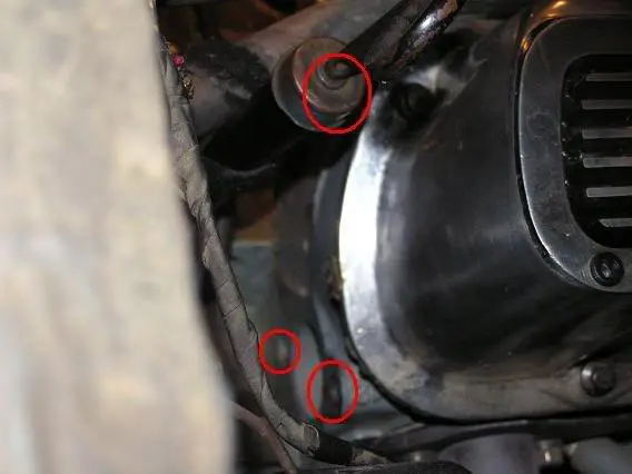

I'm attaching 2 pics - the 1st shows the protrusion on the bell housing that I mentioned in my last post. The 2nd highlights the only 3 holes on the side of the head. If it wasn't for that protrusion I could probably reach the hole hidden behind the heater hoses.

If it's never been attached to anything, the tab may be bent in the wrong direction. It may help if you can see which side of the tab the bolt seated on and which side was against a flat surface.
