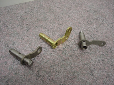

Hey I messed up and gave you info about the transmission in my son's 69 coupe. My 65 fastback has the following transmission codes; D7OP-BA PEEV8. My research show either a 1977 Torino or LTD II. My problem is still that when moving the floor shifter from park to drive and the transmission actually goes from park to reverse to neutral to drive to second to first. The shifter locks into each selection, but the indicator is way off. If the "arm length" is wrong, what part number and length am I looking for?
Thanks for your help.
The one on the right is the C4 part.
shifter
I had the same problem with my 65 Mustang, so I fabricated a short extension and bolted it to my floor shift lever. This extended the throw so that everything lined up. Might not be the "correct" way, but it got me on the road. That was 10 years ago. I may get around to fixing it the "right" way in the next 10 or 15 years, but for now it is working great.
Seems that in my instance it might be easier to fabricate an extension. Any one know the correct center to center hole measurement for a "Mustang floor shift select lever" like the one on the right in the picture provided above? Thanks.
