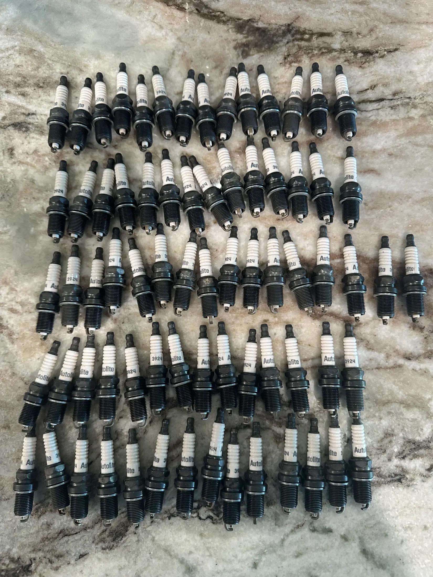

Well all 72 plugs showed up and look good. Packaging was less than stellar but they made it.

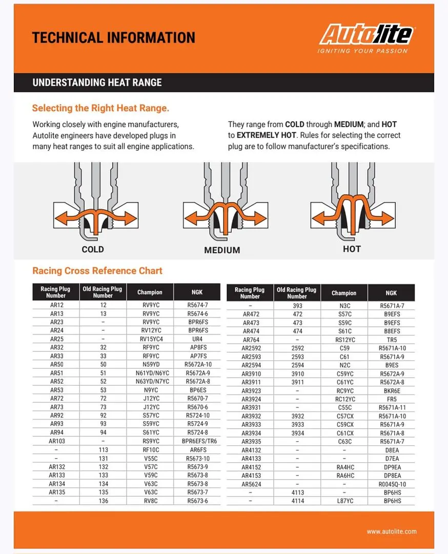

Does NGK make a resistor type, non projected, gasket seat spark plug in the 8 or 9 cold range for TFS 11R heads? Or, what heat range is appropriate for a 200hp dry shot on a progressive controller?

I wouldn't go colder than 8. It's pretty damn cold and equivalent to 3922 or so. I'm running a 3923 in my daily with a 150 wet shot. Your compression and tune of course play into this, so of course read the plugs and give the car what it wants. Now back to your question, I asked chatGPT the other night for the same thing and the answer was no. If you find something else, let me know too. That said, it looks like it's either projected tip streetcar type plug, or race plug.

I run 9s in my motor , 20511r heads
NGK5238
R5671A-9
NGK heat ranges work backward so if you wanted a little warmer plug -8 or -7
Colder would continue to go up in number. These are non resistor though.

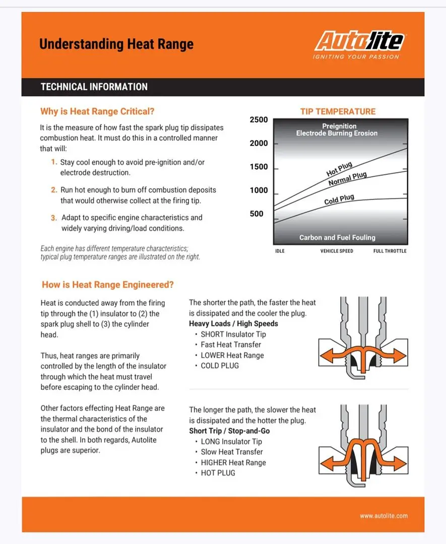

Have you guys confirmed 9s are right by the temp transition point on the ground strap? I think the 8s are a pain to keep from fouling for street use.

I found this link at Autolite.com
https://www.autolite.com/media/wysiwyg/tech_specs/Autolite_Understanding-Heat-Range_.pdf
