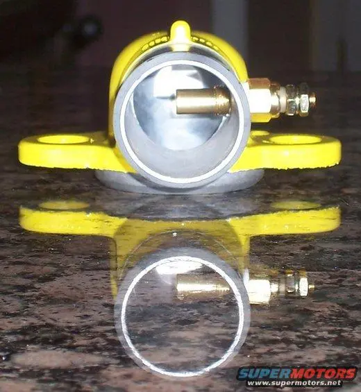

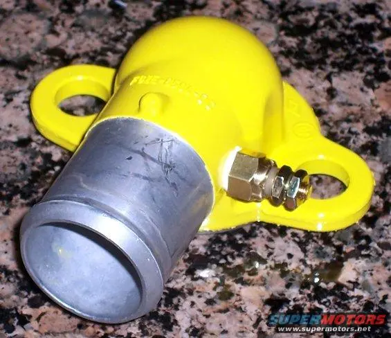

Place sensor in the side of the housing so it's always the coolant flow.
