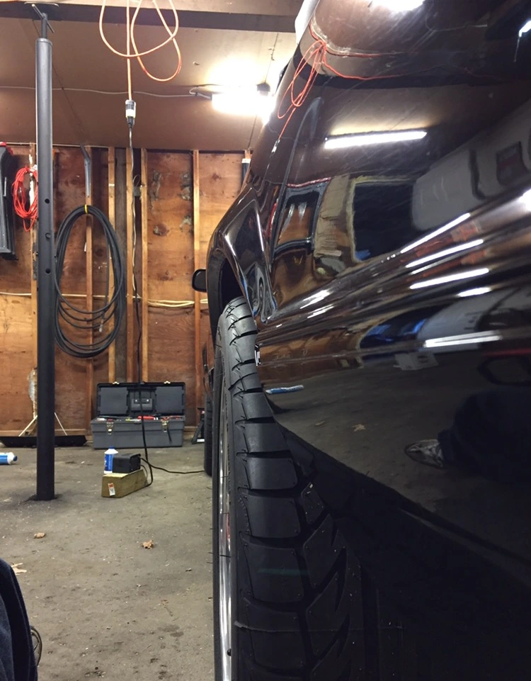

My car with the cobra brackets, 17x8s and 255s. It's right in the edge. A 17x9 would stick out. You could compensate with deeper backspacing but your wheel selection is more limited.

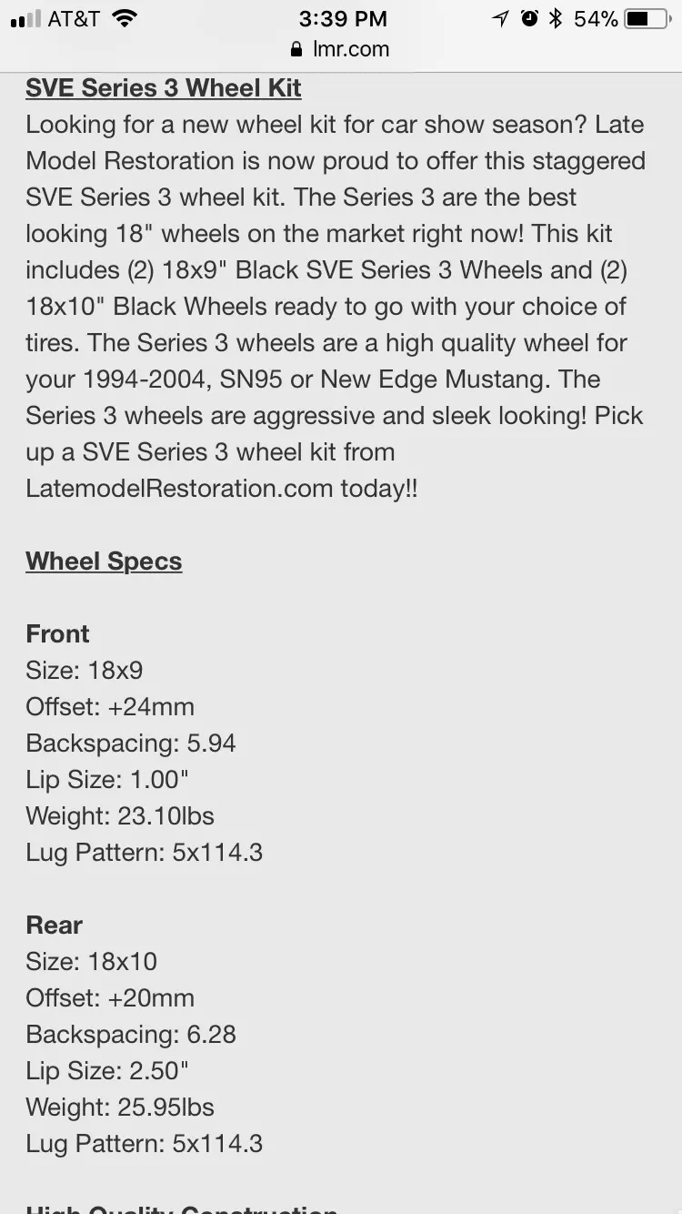

Ok so chiming in here, I am looking to go five lug swap, full disc. So I’ve seen ppl with similar 18s whether the are CCwheel of esr wheel, I really like these. I’m not in a rush but I’m wanting eventually get the change going. Anyways, I have been told as Long as the off set is correct fitment is no issue. I’m clueless with this stuff but these are what I want and I’d like them to fit flush like up above or close. Is there a certain brake, axle, spindle etc set up I’d need to use vs any others I’ve seen talked about?
